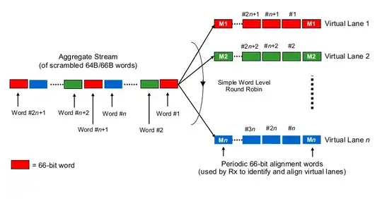

The part that does the division to multiple lanes is called Physical Coding Sublayer in IEEE 802.3ba standard. This presentation by Gary Nicholl gives a good overview of it.
The short explanation is that the data is divided to multiple lanes in blocks of 64 bits each (encoded on wire as 66 bits for clock recovery). Therefore as soon as packet size exceeds N*64 bits (= 32 bytes for 4 lanes), it can fully utilize all lanes. There will be some delay in the encoding, but that is probably implementation-specific.
This diagram is from the presentation linked above: Physical Coding Sublayer function

    Ah, thanks for that. The way I understand it, these "Words" are the "suitably sized chunks of bits", as I put it in my original post. Does that come close? – Marc 'netztier' Luethi Oct 03 '18 at 12:16
    @Marc'netztier'Luethi Exactly. – jpa Oct 03 '18 at 12:19
