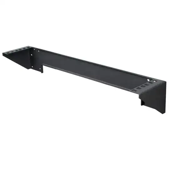

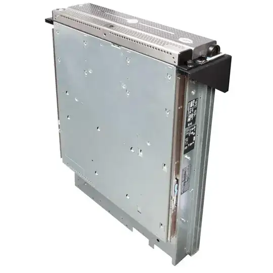

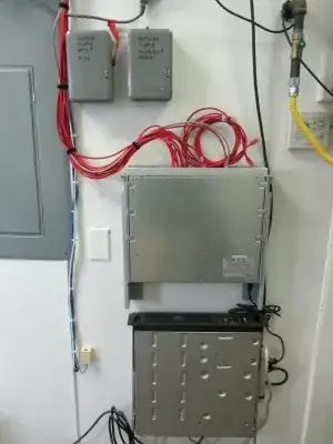

I don't know if there are any commercial solutions to this problem, (I'm sure there are) we've just been solving this for many years with a little bit of "macguyvering".
We take a rack-mount shelf such as this one, and flush mount it to the wall/pressboard in the closet with anchors.
Then, we simply put the standard rack ears on our gear, and hang the equipment vertically from the ears of the shelf.
We use this in MANY closets as a cheaper/more space efficient alternative to putting a two-post rack or a wall hanging cabinet in there.
I've attached a couple of pictures for clarity:
Flush Mounted Switch and UPS Wide Angle of Flush Mounted Switch
Also, YES this is in a kitchen and under the hot-water heater... Not by our choice, but that's where the wiring was terminated when we took over the building. As most of you know, you play the hand you're dealt... :)
