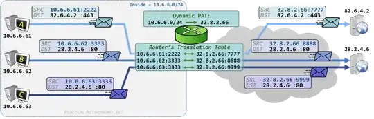

A NAT (Network Address Translation) does not actually translate the port. You are most likely referring to a PAT (Port Address Translation).
Even more specifically, you are likely referring to a Dynamic PAT -- which is a type of translation which allows any number of internal hosts to share one or more public IP addresses:
Dynamic PAT Outbound illustration - pracnet.net/nat
In the illustration above, notice all three hosts initiate connections to a destination on the Internet. All three hosts (A, B, and C) select their own source ports randomly (2222, 3333, and 3333, respectively). When their packets traverse the translation device, the router selects new source ports (7777, 8888, 9999, respectively).
This is crucial, because the re-writing of the source port is what allows the return traffic to be forwarded back to the correct initiating host:
Dynamic PAT Inbound illustration - pracnet.net/nat
The Router made note of the mapping between initial source port and post-translation source port, and uses that to correctly return the response traffic to the correct host.
Had the Router NOT re-written the source ports, both Host B and Host C's return packets would have been to the same destination port:
Dynamic PAT - WITHOUT Re-Randomizing Source Port - pracnet.net/nat
When those packets would make their way back to the Router, there would be no way for the Router to know which packet should have gone to Host B and which packet should have gone to Host C.
Hence, it is crucial for the Dynamic PAT device to also re-write the source port to ensure the return traffic can be successfully returned to the original host.
To learn more about Dynamic PAT's operation, check out the Dynamic PAT Article in the Network Address Translation article Series
