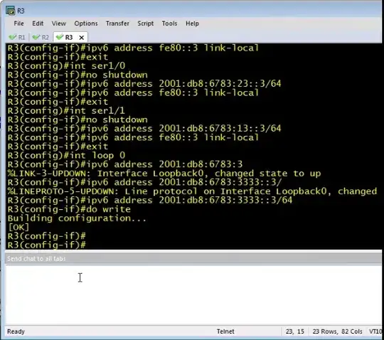

if you use the same constructor(Cisco for example) for your network devices, SecureCRT is your best choice. it is an SSH client that give you the possibility to send commands at multiple terminals at the sale time:
secrureCRT
to set that up: 1. connect to all your devices in different tabs 2. go to view 3. check "chat window" option 4. right click on the window -> check "send chat to all tabs"
