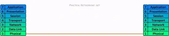

The OP asked this question in comments:
only bits come out of the physical layer for transmission. So does Router convert them back to packets upon receiving bits as input?
The answer is "eventually yes". Each layer adds to the original data what it needs to add in order to accomplish its purpose:
  • Layer 3 (the Router) will add an IP header which would include a Source and Destination IP address
  • Layer 2 (the NIC on the Router) would add an Ethernet header which would include a Source and Destination MAC address
Layer 2 would then convert the resulting frame into 1s and 0s and send them to Layer 1 to be sent across the wire.
The process can be seen in this animation:
Eddie
  • 15,026
  • 44
  • 84
  • My doubt is router is for routing packets where as only bits come out of the physical layer for transmission. So does Router convert them back to packets upon receiving bits as input? – amruth polavarapu Sep 08 '16 at 03:09
  • @amruthvenkat Eventually, yes. The router deals with packets, then passes the packet to L2, which deals with the frame, which then converts the frame into 1s and 0s to pass it across the wire. Take a look at the encapsulation and de-encapsulation process... in fact, I'll edit the animation into my answer because its relevant, and I'm really proud of it. – Eddie Sep 08 '16 at 06:24
