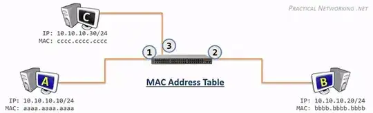

Good question. I'll answer it with an animation:
When Host A sends the frame, the switch does not have anything in its MAC address table. Upon receiving the frame, it records Host A's MAC Address to Switch Port mapping. Since it doesn't know where the destination MAC address is, it floods the frame out all ports.
This assures that if host B exists (which at this point, the switch does not know yet), that it will receive it. Hopefully, upon receiving the frame, Host B will generate a response frame, which will allow the Switch to learn the MAC address mapping from the return frame.
You can read more about how a Switch works here (where I took the animation from). I would also suggest reading the entire article series for a closer look at how a packet moves through a network.
One last note regarding the terms Flooding vs Broadcast. A switch never broadcasts frames, a broadcast is not an action a switch can take. A switch can only flood a frame. A broadcast is simply a frame with a destination MAC address of ffff.ffff.ffff. This is often confused because the end effect is the same, but they are actually different.

  • The main difference between flooding and broadcasting is how the next node(s) will react – Ferrybig Apr 05 '16 at 20:47
    @Ferrybig Correct. But I would phrase it slightly different...The main difference between a switch flooding a unicast frame, and a switch flooding a broadcast frame is how the next node(s) will react. There is no such thing as a switch broadcasting a frame. (This comment, and my answer, is speaking of transit traffic, not management traffic to/from the switch) – Eddie Apr 05 '16 at 21:16
