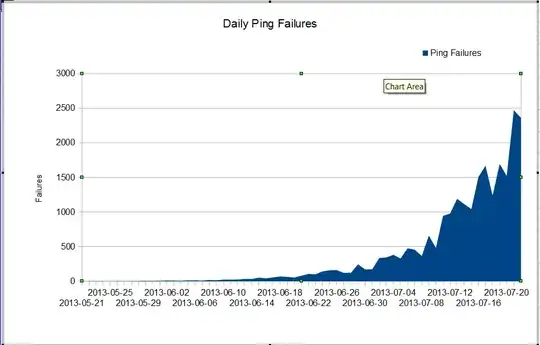

We use the Cisco ASA 5585 in a layer2 transparent mode. The configuration is just two 10GE links between our business partner dmz and our inside network. A simple map looks like this.
10.4.2.9/30                    10.4.2.10/30
core01-----------ASA1----------dmzsw
The ASA has 8.2(4) and SSP20. The switches are 6500 Sup2T with 12.2. There are no packet drops on any switch or ASA interface!! Our maximum traffic is about 1.8Gbps between the switches and the CPU load on the ASA is very low.
We have a strange problem. Our nms admin sees very bad packet loss that started sometime in June. The packet loss is growing very fast, but we do not know why. Traffic through the firewall has remained constant, but packet loss is growing quickly. These are the nagios ping failures we see through the firewall. Nagios sends 10 pings to every server. Some of the failures loose all pings, not all failures loose all ten pings.
The strange thing is that if we use mtr from the nagios server, the packet loss isn't very bad.

When we ping between the switches, we don't loose many packets, but it is obvious the problem starts somewhere between the switches.
core01#ping ip 10.4.2.10 repeat 500000
Type escape sequence to abort.
Sending 500000, 100-byte ICMP Echos to 10.4.2.10, timeout is 2 seconds:
Success rate is 99 percent (499993/500000), round-trip min/avg/max = 1/2/6 ms
core01#
How can we have so many ping failures and no packet drops on the interfaces? How can we find where the problem is? Cisco TAC is going in circles on this problem, they keep asking for show tech from so many different switches and it is obvious that the problem is betwen core01 and dmzsw. Can someone help?
