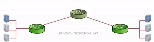

Just wanted to add this animation to complement the accepted answer.
mac/ip
(This awesome GIF is from here.)
