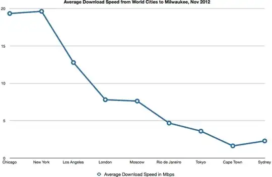

-2
Yes, here's real word data, not just theory.
Source: Average Download Speed From World Cities, Andrew Martin
Graphs
Jonathan
  • 113
  • Link only answers are discouraged. Please provide details which make this answer useful without depending on the linked webpage. – Teun Vink Aug 11 '17 at 05:05
  • Dude, it's not a link only answer, it's a image with statistics – Jonathan Aug 12 '17 at 21:21
    I'm not your dude. Also, this image has no meaning without an explanation what's on the Y-axis and how it was measured. And even then, you should explain how this image is an answer to the question. – Teun Vink Aug 12 '17 at 21:43
  • I don't know why it's difficult for you, but the X and Y axis are labeled. "Average Download Speed in Mbps" – Jonathan Aug 16 '18 at 23:29
