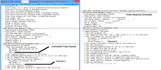

I am monitoring the 802.11 traffic in my network, and especially the active probing from my smartphone. I am sending Probe Requests for certain hidden SSIDs, but also an Undirected Probe Request, supposed to reveal networks matching the capabilities announced by my device.
I am in Europe, so we get to use more channels than in the US I think (right?) and thus they overlap.
As expected, the scanning takes place on different channels in turn, but what surprises me is this behaviour:
An undirected probe request sent on channel 5 is answered by an AP on channel 6. Is this completely normal behaviour i.e. defined anywhere in the official specs?
EDIT: Here is the content of both probe request and response, I am basing my assumption on the DS Parameter Set: Current Channel. Picture on i.imgur
The time difference between the two frames is 4ms, and I did not observe any other activity on the waves during this time period.

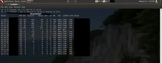

EDIT: Here is the command I run with airodump-ng 1.0 airodump-ng -c 6 mon0
and the capture tool shows beacons coming from APs on channel 2 to 9. To me it means that airodump accepts all packets visible on a frequecy range, without dismissing them according to the Current Channel Parameter, makes sense for performance reasons.

root@mymachine:~# airodump-ng mon0 --channel 6 -w out --output-format pcap :: start a capture on channel 6, write to a file.
Observation: airodump-ng doesn't display any change in channel, the top left corner is fixed on number 6. However, beacons observed on channels 2 to 11... -> Apparently no selectivity and passing the arguments to both airmon-ng and airodump-ng seem pointless.
Observed with:
CHIPSET Intel 4965 driver iwlwifi
CHIPSET Atheros AR 9271 driver ath9k
Screenshot: screenshot

    Are you specifically making the device only send out probes on channel 5? Otherwise, a device will probe on all channels and listen to responses on those channels (less than 100ms). I can only think that would be the reason why you're getting responses on channel 6. (This will happen even if your card is set to use a specific channel, its just how probing works) –  Jul 09 '13 at 14:55
  • @Artanix I understand that the card sends probe requests on every channel, but it does so in turn, and I see them: I am wondering if I may have missed some packets during the capture. I will upload a wireshark screen shot. – olamotte Jul 10 '13 at 08:08
  • Quite interesting. The delay between channels isn't that big, but if its definitely happening the way you're suggesting. Then I'd say you've answered your own question as "yes" ;) I don't have a wireless card that works with wireshark yet, so I can't test myself. –  Jul 10 '13 at 08:42
  • @Artanix I could see an advantage in answering requests on multiple channels, only if the AP selection process is -first come, first served-, and connecting the card to the first satisfying network, without caring about the nearby unscanned channels. Doesn't sound great though, and it is not what my card is doing. I noticed this behaviour only with one of my APS, a Netgear WNR1000v2 with firmware v1.1.2.58 – olamotte Jul 10 '13 at 08:54
  • @olamotte, I played with airodump-ng with three different adapters, and on none of them when I specify a channel do I see anything on any other channel than the one specified. Can you verify it isn't scanning when you run airodup-ng (top left corner should indicate current channel)? – YLearn Jul 14 '13 at 04:50
  • @YLearn It is fixed on channel 6. Let me get to work and I will make a screenshot. I precise the channel when calling airodump, and it is not looping on all the channels. Are there are any networks on other channels in your surroundings ;) ? – olamotte Jul 15 '13 at 07:52
  • @olamotte, yes there are other networks, both on the same channel and others. I tested in three locations (a quiet residential, a busy residential and an EDU with research networks on a number of channels) and none of them showed any beacons other than the channel specified when I ran airodump-ng. – YLearn Jul 15 '13 at 16:37
What happens is that your wireless device, even when tuned for channel 6 (2437) also have a small probability to receive frames from neighboring channels, such as channel 5 and 7. and even further (with less probability).
This is highly dependent on the wireless interface that you use. The worst radio that I found was an AR9170 based USB adapter, which was able to pick traffic on channel 1 when turned for channel 6. Some other interfaces (e.g. AR9280) do not have this problem, or it is fairly reduced.
PS: AR9271 is not supported by the ath9k driver, but by the ath9k_htc driver. Because this card seems to be the natural successor to AR9170, I am not surprised that you experience the same issue.

Wireless captures are not the same as a wired capture. In a wired capture, you simply pick your interface and start capturing frames.
With a wireless capture, you select your adapter, but then you also need to choose if you are going to monitor one channel or scan across multiple (or all) channels. There are advantages to both and one needs to understand when to use each.
In your example, since you are capturing on two different channels, either you are using two different capture devices or you are capturing while scanning channels, but I presume you are scanning. What this means is that it stops on one channel for some period of time, captures traffic and then moves onto the next.
So here is how I see this most likely playing out:
  1. Capture device starts monitoring on channel 5.
  2. Client device send probe request on channel 5.
  3. Client device moves to channel 6 and sends probe request.
  4. Capture device moves to channel 6 and starts monitoring.
  5. AP sends probe response on channel 6.
In the end, your capture picks up the probe request on channel 5, but then the probe response on channel 6.
Every wireless capture tool I have used will allow you to select a single channel to monitor. I suspect if you set this to channel 5, you will get the probe requests with no responses. If you set this to channel 6, you will see both the probe requests and the responses.
