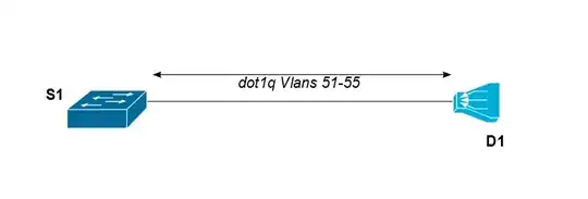

I am in the middle of a project to migrate some existing switched ethernet dot1q trunks behind an ASA firewall... these trunks have five vlans each (numbered 51 - 55). This is a simple drawing of the original layer2 service...
VLAN_Translation_00

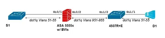

One of the requirements is to have an ASA firewall context per Vlan in the original dot1q trunk. This means I wind up using a BVI to bridge the new INSIDE interface to the DMZ interface in each FW context. Due to other constraints, I wind up with a FW config like this (I am summarizing out all the context stuff to simplify the question)...
firewall transparent
interface GigabitEthernet0/1.51
 vlan 51
 nameif INSIDE
 security-level 100
 bridge-group 1
interface GigabitEthernet0/2.951
 vlan 951
 nameif DMZ
 security-level 50
 bridge-group 1
interface BVI1
 ip address 10.10.51.240 255.255.255.0 standby 10.10.51.241
Cisco ASAs in transparent mode wind up using two different vlan IDs to connect a single layer2 vlan service. Connect the two vlans through interface BVI1; the bridge-group 1 configuration on each physical interface makes the connection between Vlan51 and Vlan951 in the config above.
Assume ASA:Gi0/2 connects to 4507:Gi1/2... Notice what happens to the DMZ interface... the ASA DMZ Vlan is 951, and this connects via a dot1q trunk to the DMZ switch (the Cat4507). I need to connect D1 to switchport 4507:Gi1/1, but I must deliver the Vlan951-955 services to D1 as dot1q Vlan51-55 on 4507:Gi1/1. In other words, the Vlan BVI wrangling I had to do on the ASA messes up the Vlan numbering in my original service definition.
VLAN_translation_01
Sadly, I cannot easily renumber the Vlans on D1. The perfect solution would be to somehow translate Vlan951 on 4507:Gi1/2 to Vlan51 on 4507:Gi1/1. Cisco has a feature called vlan mapping, but it seems to require QinQ... all my services are simple dot1q... the 4500 vlan mapping docs are not clear about how they handle simple dot1q encapsulation.
I know I can translate the vlans in the 4500 via loopback cable, but this burns two extra ports per Vlan... a total of ten extra ports for all the Vlans in the service (v51 - v55).
Question
Refer to the diagram below.
VLAN_translation_01
How can I translate all Vlans numbered 95x on the 4507:Gi1/2 dot1q trunk to be numbered Vlan5x on 4507:Gi1/1 dot1q? I need to use the fewest number of ports consumed for "translation overhead". Please include configs for all ports that your answer requires.
I am open to vlan mapping, if someone can explain how it would work in this topology...

I don't have SUP7 to test, but it works on SUP6 and SUP32, I would presume SUP7 retains this functionality.
I've tested between JNPR M320 <-> SUP32, and 'vlan mapping JNPR SUP32' works just fine.
There is no need for QinQ, what the QinQ option does is it adds top tag to one particularly tag. So switchport vlan mapping 1042 dot1q-tunnel 42 would map incoming [1042] stack to [42 1042] stack. As opposed to switchport vlan mapping 1042 42 which maps incoming dot1q Vlan [1042] to dot1q Vlan [42].

  • Thanks for the example... So far, you're using an SVI to replace what I'm calling Gi1/1 in the original question; however, this would be a better answer if it proves that you don't need QinQ encap to share Vlan42 beyond the Sup32 itself. I will try it myself when I get to work if you don't answer sooner... – Mike Pennington Jul 09 '13 at 11:28
    There is no QinQ at all involved. Imagine your FW is my M320 and your SUP7 is my SUP32. In your SUP7 FW port you just rewrite the FW VLAN to what it should be externally 'switchport vlan mapping ' – ytti Jul 09 '13 at 11:37
    Cisco does VLAN mapping two ways. QinQ is used to preserve the original VLAN tag while traversing a "foreign" network such as a SP. One-to-One VLAN mapping, which is what is shown here, swaps dot1q tags, changing the VLAN ID when forwarding or receiving on the given interface. Both would work for question given. – Santino Jul 09 '13 at 11:55
  • QinQ application is mostly this CustL2 -- OperL2 -- CustL2, then in operL2 ports facing CustL2 you configure 'switchport mode dot1q-tunnel' and 'switchport access vlan 42'. And all CustL2 VLANs would transit OperL2 as '[ 42 X ]'. However at OperL2 all these share single MAC table, so it's not fully transparent, you can't have colliding X in VLANs in different Cust sites. MACinMAC (PBB) is more transparent solution with better scaling (MAC use in core). – ytti Jul 09 '13 at 12:16
  • FYI, it looks like switchport vlan mapping enable is not required on Sup7... – Mike Pennington Jul 09 '13 at 14:48
