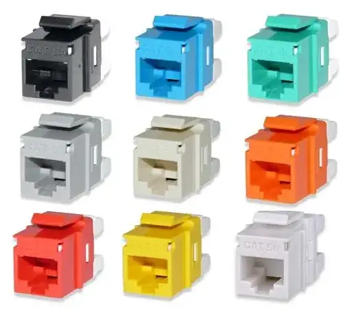

In a similar vein as this question...
Are there any conventions or standards that recommend a color scheme for the colors of Ethernet keystone jacks?
colored jacks

My personal experience is that we use whatever color matches the paint in the room its in, unless it is one of the following:
Red: Hospital Monitoring Equipment
Blue: Security Cameras
Green: Any separate LAN or VLAN connection (ie. radiology has a few of these)
I don't believe there is a specific standard for them.
Correction: as Comments state below talk to your AHJ
    Many times, it may be up to the local Authority Having Jurisdiction. My company had a color scheme which we used everywhere until we ran into inspectors in some cities that each had their own color schemes. Despite any national or international standards, the AHJ always has final say. – Ron Maupin Jul 01 '15 at 19:53
  • I would assume he is the AHJ in his network if he is the system admin. – Angrod Losshelin Jul 01 '15 at 19:56
    That would be an incorrect assumption which could get someone in a lot of trouble by having an entire building red-tagged as unfit for occupation until the problems are corrected. The local building inspector, fire marshal, etc. would be the AHJ. There are a lot of laws around cabling that need to be met. – Ron Maupin Jul 01 '15 at 20:04
  • @ronmaupin, can you cite specific instances where an inspector would care about the jack color? – Mike Pennington Jul 01 '15 at 23:57
    @Mike Pennington, for instance, in Plano, TX, red is strictly reserved for lifeline services. I'm not completely sure of the definition, but we were not allowed to use red. There are a few other places in the over 200 cities and towns in the DFW Metroplex that have (or building officials claimed to have) various rules governing color coding of cables and jacks. I have often thought that some of the AHJ officials were just flexing as a show, but what are you going to do? – Ron Maupin Jul 02 '15 at 02:55
  • OP asked for conventions or standards, not personal preferences. – generalnetworkerror Jul 04 '15 at 08:52
Here is the standard I use across our WAN
We also use a color coding standard for the cables. - Blue cables for data - Yellow cables for Voice and phones - Green for Audio/Video (Televisions, cable boxes, etc.) - Purple for Wireless access points - Black for security cameras - Red is reserved for Fire systems and alarms
