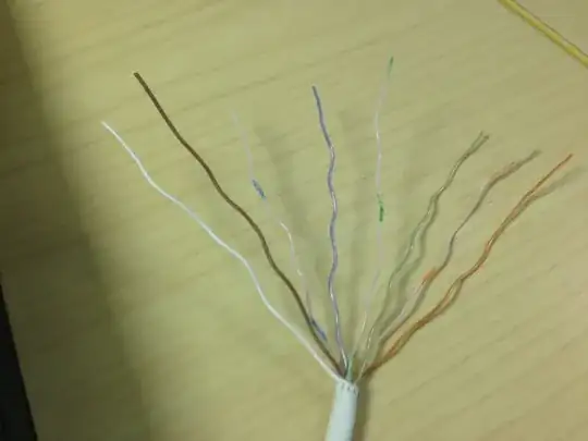

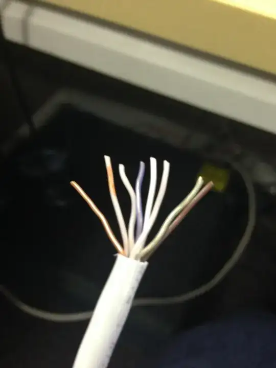

I'm learning how to make my own Ethernet cables (to get deep understanding of Cisco for their exams), but the cables I am getting have small wires whose colors I cannot distinguish.
A person in my organization who is expert at making Ethernet cables insists he can see the colors as they are. Is this another case of what color is that dress? Seriously.
Really, I am so stumped right now, and I've seen two CAT5 cables like this, where the colors are faded and indistinguishable.
How can I create my own Ethernet cables when I cannot figure out the faded color of these wires? Is it that the cables are too old and the colors get faded over time? Is there another solution. I really wish to create Ethernet cables.
UPDATE:
I stripped more of the cabling. What is supposed to be brown/white is plain white, and the rest of the white/color combos are plain faded
UPDATE II
On the cable it is printed:
0100 FEET CAT-5e General Cable L CMP (UL) C(UL) 4PR 24AWG GENSPEED 5000 PLENUIM --- VERIFIED (UL) CAT-5e--- 03-03 100537J1 CAT-5e
UPDATE III
Here are wires from another cable, printed:
BERK-TEK HYPER-PLUS 24 AWG CMP C(UL) US ETL VERIFIED TIA0568-C.2 CAT 5E & ISO/IEC 11801 CAT 5 26100016 FT

    If you strip the cable down further, you will see that there are 4 pairs of wires -- each pair is twisted together. That might help. – Ron Trunk Apr 24 '15 at 13:42
  • @Ron ---- I suppose it would help ..... for short term though .... is this supposed to be the color of the wires, or did the colors get faded ..... – Glowie Apr 24 '15 at 13:53
    Hard to tell. It could be faded, or the manufacturer ran out of ink, or a manufacturing problem. – Ron Trunk Apr 24 '15 at 13:57
  • @Ron --- I hope the cables work though .... these are leftovers for wiring our office!!!!!! – Glowie Apr 24 '15 at 14:13
    Color striping on Cat cables is always blotchy. Having faced the exact issue many times in the past, I start by just holding it a little farther from my eyes and thinking to myself "which one (of R/G/Bl/Br) is least likely to be one of the others?". After that? Punt. As a noob you will crimp a lot of ends that just don't work, for reasons other than the color. Just keep getting practice and the color sorting will become more natural to you. Exactly how flush each wire is to the end of the plug, and how far in the plug the jacket goes will become important and the colors will come naturally. – Jeff Meden Apr 24 '15 at 14:45
  • @JeffMeden Ah yes, that's why my co-worker was able to perfectly tell the colors apart from far distance and when only 1/2 inch of cable was stripped off ..... – Glowie Apr 24 '15 at 14:52
    After Update2: when you strip off more of the jacket it's hopefully clear how they are paired. Also, stop untwisting them! Only untwist what you need to get the wire straight into the guide on the connector. It will be easier to keep track of and you will get better crosstalk resistance. – Jeff Meden Apr 24 '15 at 14:54
  • @JeffMeden LOL good point, I'll stop untwisting them .... – Glowie Apr 24 '15 at 15:08
    After update3: that's a great example of how every cable maker does it a bit different, so you need to resort to the pairing and "which one looks least like another" method since clearly there is no real standard for how a solid vs striped color will look. Berk-Tek clearly just grabbed some clear plastic (pvc?) coated cable for Blue/Green and then added in some opaque pairs (PET plastic?) with little regard for consistency. – Jeff Meden Apr 24 '15 at 15:19

Maybe it is the dress thing, but I can make out the four solid colored wires; orange, green, blue and brown. As you work with cables from different manufacturers, you will find that not all things are the same. Some will have colors that look a bit more "faded" or even somewhat "translucent."
From there, you need to identify the white/color wires. While most manufacturers do indeed "stripe" the wire in some way, it is not at all uncommon for them to use just a white wire and it is identified by the solid colored wire to which it is twisted.
In this particular case, it appeaers there is a white/orange mark as well, so I would presume the the other white wires also have markings. However, the marks could have significant spacing, so you would probably want to strip back more of the outer jacket to expose more of the internal wires.
As to whether this is fading or something else, but significant fading typically doesn't occur unless exposed to sunlight, chemicals or some other factor. It is more likely this is just how it was manufactured, but no one could answer that without knowing the manufacturer, product number and possibly manufacturer date or lot number.
