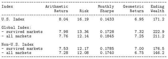

Look at the final page of the paper, "geometric returns -- represent returns to a buy-and-hold strategy" and the "arithmetic averages -- give equal weight to each observation interval.", where you can find your asked "historical effect of Rebalancing on Return and Standard Deviation". The paper nicely summarizes the results to this table:
Historical returns and Standard deviations, source the paper above.
The results in the table are from the interval 1921-1996, it is not that long-time but even longer term data has its own drawbacks. The starting year 1921 is interesting choice because it is around the times of social-economical changes and depressing moments, historical context can be realized from books such as Grapes Of Wrath (short summary here, although fiction to some extent, it has some resonance to the history). The authors have had to ignore some years because of different reasons such as political unrest and wars.

  • Doesn't the arithmetic average in the chart above presume re-balancing on a strictly time based ('observation interval') method? Considering that is only one proposed basis for re-balancing is it fair to use such a narrow approach as a broad brush to paint all re-balancing as flawed or ineffective? (here's an example of another theory: http://www.iijournals.com/doi/abs/10.3905/jpm.2003.319894 which I don't think can be modeled by using a simple arithmetic average based on equally weighted observation intervals ) – Chuck van der Linden Jul 01 '11 at 07:04
  • @Chuck van der Linden: the author is answering this question with the graph "Does it pay to rebalance assets with a 1% return difference compounded over 76 years?"´, assuming"a 1% domestic stock advantage, a 0.5 correlation between US and foreign markets, and a zero return/zero SD for t-bills"´. Sorry cannot get access to your article now but as far I can understand the author's example is ad hoc by nature. I am not actually sure whether the graph has a mistake with its labels. Why does it have geometric and not arithmetic there? He explains like comparing rebalancing and no-rebalancing. –  Jul 02 '11 at 19:16
