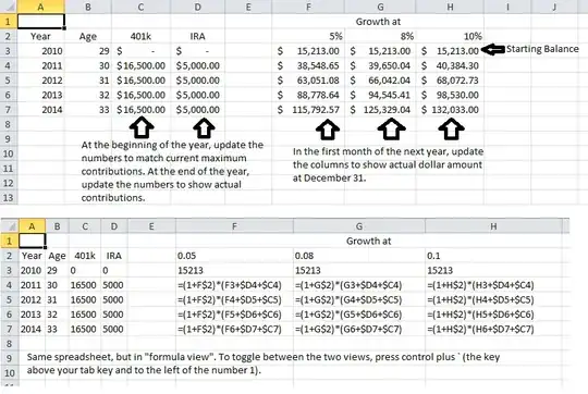

I have a simple spreadsheet that I use to calculate estimated projected balances and compare them to actual performance. Don't forget that when you reach 50, the amount you can contribute goes up due to "catch up contributions." Simple spreadsheet
There are 2 views of the same tab in this picture. There are 3 growth rates: pessimistic, nominal and optimistic. You can change the numbers to suit your own projections of future growth. Other tabs on this spreadsheet include measurements of actual performance by my 401k and IRA accounts. At the end of the year, I replace the numbers in columns F, G & H with the actual end-of-year dollar amounts. This way, future estimates do not get too far unhinged from reality.
If you need more sophisticated planning, such as Monte Carlo analysis to attempt to cope with inflation, I recommend the book Engineering Your Retirement. The book is aimed at younger engineers, so there is a bit more math than the average person would want.
