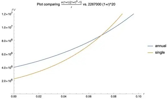

The advantage of annual payments would remain up until the bank deposit rate reached slightly over 7% at which point the advantage turns to the single payment. I.e. future value of an annuity due for the annual payments:
Future value s equals the sum of the appreciated payments a. Formula is by induction.
annuity due
Choosing r slightly over 7% for an example
  r = 0.070008
  a = 200000
  n = 20
∴ s = (a (1 + r) ((1 + r)^n - 1))/r = $8,773,867.36
vs. single payment
2267000 (1 + 0.070008)^20 = $8,773,886.56
In this case the future value from the single payment is greater.
With r > 7.00077 % is it advantageous to take the single payment. The plot below illustrates the cross-over point with the exact intercept found by solver.
Note the answer as stated by the OP is 7%.
Solution via solver
