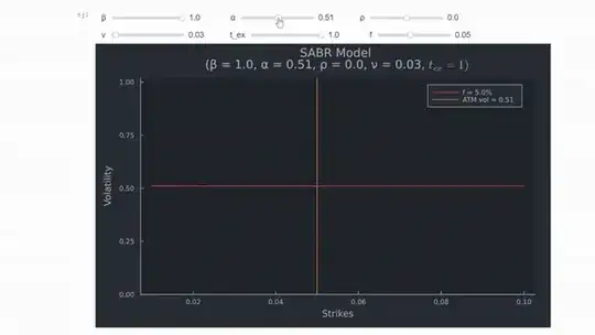

Below is a quick SVI implementation in Python example:
spot = 1.34
forward = 1.35
t = 30 / 365.0
vols = np.array([ 12, 10, 9.5, 9, 10.5, 8, 10.24, 9.6, 11.2, 9.4, 11.9, 9.7, 20, 23,  27]) / 100
strikes = np.array([1.21, 1.3, 1.4, 1.3, 1.3, 1.32, 1.38, 1.3,
                    1.4, 1.3, 1.45, 1.25, 1.5 , 1.6,  1.8])
total_implied_variance = t * vols ** 2
def svi(k, param): a = param[0]; b = param[1]; m = param[2]; rho = param[3]; sigma = param[4];
totalvariance = a + b * (rho * (k - m) + np.sqrt((k - m)** 2 + sigma**2));
return totalvariance
def targetfunction(x): value=0 for i in range(11): model_total_implied_variance = svi(np.log(strikes[i] / forward), x); value =value+(total_implied_variance[i] - model_total_implied_variance) ** 2; return value**0.5
bound = [(1e-5, max(total_implied_variance)),(1e-3, 0.99),(min(strikes), max(strikes)),(-0.99, 0.99),(1e-3, 0.99)] result = optimize.minimize(targetfunction, bound, tol=1e-8, method="BFGS") x=result.x
K = np.linspace(-0.4, 0.4, 60)
newVols = [np.sqrt(svi(logmoneyness, x)/t) for logmoneyness in K] plt.plot(np.log(strikes / forward), vols, marker='o', linestyle='none', label='market') plt.plot(K, newVols, label='SVI') plt.title("vol curve")
plt.grid() plt.legend() plt.show()
SABR calibration would involve fitting beta, alpha, rho and nu so that it resembles the shape of IV in the market. You can see details and the below illustration here.
