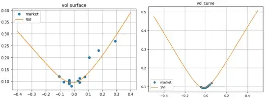

If it were not related, you would get lots of arbitrage opportunities. This answer shows how to use SVI to fit a vol surface from market quotes.
If you look at these two fictional examples, you will realize that one has several mispriced options, while the other has all options more or less aligned with the entire vol surface. enter image description here
Now in reality, you face issues like stale prices, unreasonable small or large bid/ask spreads, you need figure out a way to handle that the underlying asset and options on the asset can trade during different times on different exchanges, that there exist erratic prices, especially close to the opening and closing times of the trading session...
That is why actual shapes of IV surfaces are quite fascinating at times. Voladynamics has some great examples on their webpage.
The underlying message is the same though: IVs must be related to each other, otherwise there will be arbitrage opportunities. Since there are many firms constantly monitoring this, any such opportunity will be very short lived.
