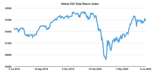

I know that I'm asking a stupid question, but I must admit that I'm lost. I've recently discovered a N225TR - i.e. the Nikkei 225 Total Return - graph and I just can't read it. I know that the y-axis shows the total return from the Nikkei, but what is the relationship between that and the x-axis? For example, the y-value for September 1, 2019 seems to be about 33,000, but what does that mean?
enter image description here]

First, a few warnings (so that you know what to do if you decide to use in the future the series in the graph you have shared):
  1. The series in the graph is actually called "Nikkei 225 Total Return Index", not "Nikkei 225 Total Return(s)". This distinction is important and I will tell more about it later on.
  2. The graph of Nikkei 225 Total Return Index you have shared from its "General" page on investing.com, purporting to show the values of the index from early July 2019 through early July 2020, shows incorrect values towards the end (not your fault; investing.com has screwed up and it still does as of yet as far as that chart is concerned). Here is the correct one for your convenience (mine looks slightly different also in detail because the graph on investing.com appears to be on a weekly basis while mine is on a daily basis).
How do you read a Total Returns chart?
First of all, the chart you have shared does not show the (percentage) returns or something similar. It just shows an index ("Nikkei 225 Total Return Index") whose daily values are the (simple) arithmetic averages of the corresponding daily closing prices of the stocks in the Nikkei 225 index. These averages, however, are rebased from an initial value of 6569.47 as of December 28, 1979 and adjusted for certain events. This value, for technical reasons, is the same as the (main) Nikkei 225 index's value as of the same date. The adjustments are due to corporate actions, such as stock splits and dividends, and the stocks added to or dropped from the Nikkei 225 index since then. You can learn more about Nikkei 225 Total Return Index from its official web page if you like.
Nearly all most-quoted versions of popular stock indices, including Nikkei 225, are the versions called "price indices" and there are usually many other versions such as "net return" or "total return”. These are created to better cater to different needs of the investors. The main difference, for example, between these three is usually based on how dividends are accounted for. In a "price" index, the index values are not adjusted for most dividends whereas in a "net return" or "total return" index, the index values are adjusted by assuming any dividends distributed by the stocks in the index are reinvested (net of or with no taxes) back into all of the index stocks. Calculating the performance of a stock index using its "net return" or "total return" version rather than the "price" version is considered to be more realistic, especially over the long term.
Now then, I think it would be better to rephrase your question as "How do you read/use a Total Return Index chart?".
Well, the answer is like any other stock index! That is, one takes any two values of the index at any two different dates and calculates how much the index has changed in percentage terms from the earlier to the later. Let us exemplify this by using the second question in your post.
For example, the y value for Sep 1, 2019 seem to be about 33,000, but what does that mean?
Nikkei 225 Total Return Index was 33127.65 as of September 2, 2019 (Sep. 1 was a Sunday). That means someone who bought only one share of each stock in Nikkei 225 as of December 28, 1979, and reinvested any dividends distributed by the stocks in the index back into the index stocks, plus bought and sold the same stocks added to or dropped from Nikkei 225, respectively, at the announced dates in between, would have seen her investment rise ideally by 404.3% as of September 2, 2019 (33128/6569 - 1).
As a second example, consider the index's value as of July 8, 2020, which was 36793.09. Someone who bought one share of each stock in Nikkei 225 as of September 2, 2019, and reinvested dividends distributed as such while buying or selling the relevant stocks as announced again, will have seen her investment rise by 11.1% (36793/33128 - 1) through July 8, 2020.

Index values often don't have a meaningful interpretation. They're typically some weighted average of prices of various stocks. Many are weighted by market cap, but others are equally weighted or may have some other weighting.
What's important is the relative change in the index over time. You can see that since about July of 2019 (the start of the x-axis) the index fell slightly, then rose, then fell sharply, recovered, and fell again. IF you take the actual values over time you can calculate the relative change over time (e.g. right now it's 0.0% since it's about back to the beginning value).
Also note that you don't "buy" the index directly.You buy funds that track the index, meaning they have the same returns or changes as the index. So you may find a fund that has a price of 20 when the index has a value of 30,000. But if the index goes up by 1% to 30,300, you should expect the value of the fund to go up 1% to 20.20.
All that to say that the absolute value of the index is not as important as the relative value of the index over time.

  • These are all fair comments, but they seem to say little on how to actually read the chart. For example, how does this differ from a normal graph showing the price of the index over time? If I take a look at the March 1st 2020 point and the May 1st 2020 point, what does the difference between their values on the y-axis mean? – J. Mini Dec 06 '21 at 17:32
  • The point at March 1 is approximately 26K. The point at May 1 is approximately 32.75K. This is approximately 26% of growth. The Nikkei 225 Total Return is comprised of 225 large, public companies on the Tokyo Stock Exchange with any dividends reinvested, so generally that 26% growth could be used as a proxy for the Japan equities market. So my final interpretation would be the Japanese stock market's value, with dividends, grew 26% over those 2 months. The index is designed to measure relative performance across time, nothing else. – Ryan Dec 06 '21 at 18:46
  • @J.Mini The relative change (e.g. up 20% or whatever the actual difference is) means that the (weighted) average value of the stocks in the index went up by 20% over that time. Practically, it means if you held an index-tracking ETF, it also went up by about the same amount over that time. The Actual difference (e.g. up 5,000 points or whatever) has no real economic meaning. – D Stanley Dec 06 '21 at 19:00
No, the y-axis shows a quantity ("total return index") that is defined so that its percentage change from one date to another equals the total return of a portfolio invested in the Nikkei 225 for that period.
A total return index (for the Nikkei, the S&P 500, or any other portfolio) is an artificial construct. Its value on any given day is not determined by the prices of assets on that day. Rather, the total return index is calculated from its own value on the previous day, accounting for the daily movement in stock prices and any dividends paid by those stocks. The latter part (dividends) is where the total return index differs from the ordinary "price index" (e.g. the commonly quoted Nikkei).
The absolute normalization of the total return index is arbitrary as long as it remains consistent. That is, you could multiply it by a constant factor over its entire history and it would remain an equally valid total return index. It is likely that the Nikkei 225 Total Return was defined to equal the ordinary Nikkei 225 as of some date in the past.
Another way to understand it: If you invested $1000 in the Nikkei 225 on date X when the total return index was N225TR(X), and kept that portfolio with dividends reinvested until date Y, your resulting portfolio value would be N225TR(Y) * $1000 / N225TR(X).

The Nikkei is a price weighted index of 225 firms. So, to provide a smaller example of three firms, if they had a price of ${3,5,7}$, then the index would be $5$ as long as no stock splits or stock dividends happened. It is the simple mathematical average of the prices. If a stock split or dividend happens, then the denominator would have to be changed to make it equivalent to the prior index. Because of that, you cannot just add up the prices and solve it yourself, but it is basically an average.
A single yen is about one penny in U.S. money, so the Nikkei looks like a big number.
To calculate a return without dividends, take the future value of the Nikkei and divide it by your starting value. After that, subtract one and multiply the result by 100% to get the percentage return.
It won't quite match what you end up with what you would have if you bought all 225 members of the index, even if you didn't have to pay commissions, because of the correction factors that have built up over the decades. It also does not include dividends. Any company paying a dividend would have a higher return than its composite value in the Nikkei because the dividend component of returns is not considered.

  • This seems more like a general explanation of what an index is than an explanation of how to read a Total Returns chart. – J. Mini Dec 06 '21 at 17:29
  • That is not a Total Returns Chart. It is a chart that shows the Nikkei Total Return Index, which is not denominated in returns but in index values. I do not know if it is a translation issue into English, but the Nikkei has never produced "returns" as is understood in English but instead it provides raw index values. – Dave Harris Dec 07 '21 at 03:27
