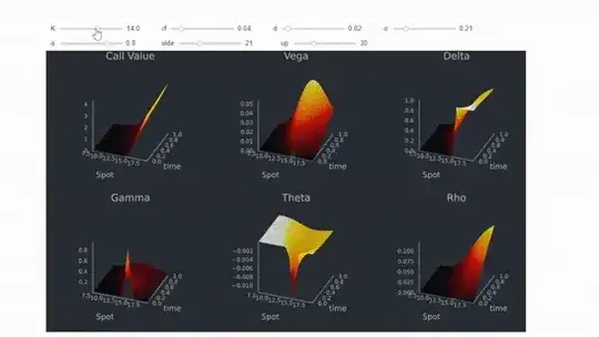

Or if you prefer 3D graphs, 18 lines of code define Black Scholes Merton including most relevant Greeks and chart all of them in one interactive chart:

Another advantage with Julia is that it is super fast compared to other high level languages like Python. This is useful here because the short clip repriced ~50,000 options to get all 3D charts including adjustments. You can have a look at some basic explanations for the reason why Julia is so fast here. These are the results: enter image description here
