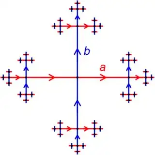

Using $\widetilde{X}$ to denote the universal cover, by standard covering-space theory the derived subgroup $F_2^{\prime}=[F(a, b), F(a, b)]$ is isomorphic to the fundamental group of $\widetilde{X}/F_2^{\prime}$. Now, $\widetilde{X}$ is just the Cayley graph of $\langle a, b; -\rangle$,
Free group Cayley graph

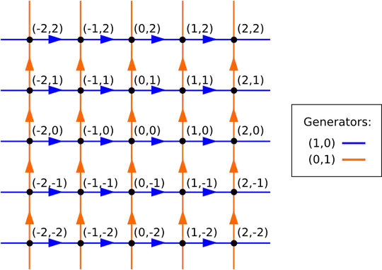

while $\widetilde{X}/F_2^{\prime}$ is the Cayley graph of $\mathbb{Z}\times\mathbb{Z}$,
Quotient complex
Then, $\pi_1(\widetilde{X}/F_2^{\prime})$ is the group with presentation $\langle V; R\cup T\rangle$ where $V$ is the set of $1$-cells (edges) of $\widetilde{X}/F_2^{\prime}$, $R$ is the set of $2$-cells of $\widetilde{X}/F_2^{\prime}$, and $T$ is a spanning tree for $\widetilde{X}/F_2^{\prime}$. Now, $\widetilde{X}/F_2^{\prime}$ has no $2$-cells, and taking any spanning tree we are still left with infinitely many edges (for example, take the tree $T=\bigcup_{y\in\mathbb{Z}}\{(x, y): x\in\mathbb{Z}\}\cup\{(0, x): x\in\mathbb{Z}\}$). Hence, we have an infinitely generated group with no relations, so $F_2^{\prime}=[F(a, b), F(a, b)]\cong F_{\infty}$ as required.
