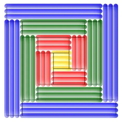

The answer is YES, you can cover the plane by non-degenerate line segments.
It is clear one can cover
  • any $1 \times 1$ closed squares (i.e those isometric to $[0,1] \times [0,1]$ ) by line segments of length $1$.
  • any $1 \times n$ quarter-open rectangles ( i.e. those isometric to $[0,1) \times [0,n]$ ) by line segments of length $n$.
You then proceed to cover $\mathbb{R}^2$ by
  1. first placing a $1 \times 1$ closed square in the center.
  2. surround the $1 \times 1$ closed square by four $1 \times 2$ quarter-open rectangles. The "open" sides of the rectangles will be facing "inwards" and the five quadrilaterals together form a $3\times 3$ closed square.
  3. surround the $3 \times 3$ closed square by four $1 \times 4$ quarter-open rectangles. The "open" sides again facing "inwards" and the nine quadrilaterals together form a $5 \times 5$ closed square.
  4. Just repeat this procedure. If you have a $(2k-1) \times (2k-1)$ closed square, you surround it by four $1 \times 2k$ rectangles to form a $(2k+1) \times (2k+1)$ closed square.
Following is a picture illustrating the arrangement of the squares/rectangles of line segments.
  • The line segments are represented by color bars.
  • The black lines indicate the the boundaries of the squares/rectangles.
Cover plane by line segments

  • @EricStucky I don't understand the construction in your comment but it is very likely to be equivalent. In this sort of construction, a picture definitely worth more than thousand words ;-p – achille hui Oct 17 '14 at 08:37
  • Actually, I realized after saying it that the constructions are quite different. In particular, if we ignore the center, yours has rotational symmetry, but while mine has the suggestion of reflective symmetry, I don't think it actually achieves it. – Eric Stucky Oct 17 '14 at 08:53
