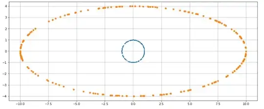

Here's the code, This works in ANY dimension :
import numpy as np
dim = 2 r=1 a = 10 b = 4 A = np.array([[1/a**2, 0], [0, 1/b**2]]) L = np.linalg.cholesky(A).T
x = np.random.normal(0,1,(200,dim))
z = np.linalg.norm(x, axis=1) z = z.reshape(-1,1).repeat(x.shape[1], axis=1) y = x/z * r y_new = np.linalg.inv(L) @ y.T
plt.figure(figsize=(15,15)) plt.plot(y[:,0],y[:,1], linestyle="", marker='o', markersize=2) plt.plot(y_new.T[:,0],y_new.T[:,1], linestyle="", marker='o', markersize=5) plt.gca().set_aspect(1) plt.grid()
And here's the theory : https://freakonometrics.hypotheses.org/files/2015/11/distribution_workshop.pdf

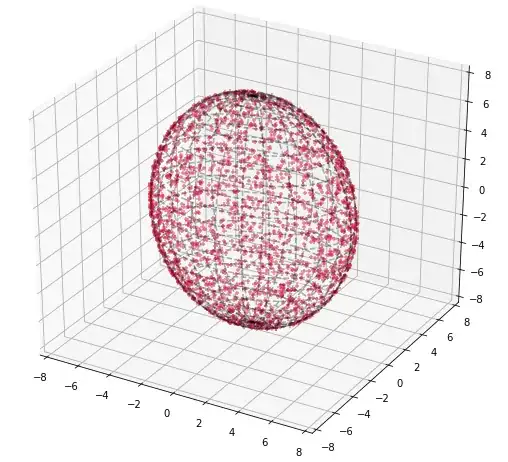

I have been working on this problem this week and I have found the following approach effective.
The ellipsoid is parameterized by
$$\vec f(t, u) = \begin{bmatrix}a \cos u \cos t \\ b \cos u \sin t \\ c \sin u\end{bmatrix}, \quad \begin{align}t &\in [0, 2 \pi] \\ u &\in [0, \pi]\end{align}$$
Naively, we might pick $T \sim U(0, 2 \pi)$ and $U \sim U(0, \pi)$ and choose $\vec f(T, U)$ as our random point, but this is equivalent to stretching the sphere, which creates distortion as others have pointed out.
Instead, define the regions
$$\begin{align} D_{t'} :\quad & t \in [0, t'] , && u \in [0, \pi] \\ D_{u'} :\quad & t \in [0, 2 \pi] , && u \in [0, u'] \end{align}$$
And the functions
$$\begin{align} S_t(t') \equiv & \iint_{D_{t'}} dS \\ S_u(u') \equiv & \iint_{D_{u'}} dS \end{align}$$
That is, $S_t$ yields the cumulative surface area on $t\in [0,t']$ and for all $u$ , while $S_u$ does vice-versa.
Next, pick two numbers $X_1, X_2 \sim U(0,A)$ where $A$ is the total surface area $$A = S_t(2\pi) = S_u(\pi)$$
Since $S_t$ and $S_u$ are monotonically increasing over the parameter space, they can be evaluated numerically and inverted through interpolation.
Our random parameters are then
$$\begin{align} T = S_t^{-1}(X_1) \\ U = S_u^{-1}(X_2) \\ \end{align}$$
And a random point on the surface is $$\vec f(T, U)$$
The advantage of this method is that because we don't have to discard any points, we don't need to compute a multiplicative factor particular to this ellipse (as another answerer does). In fact, this method picks points uniformly distributed on any parametric surface whose parameter region is square.
It is also computationally efficient, because we can use the same data (namely, a grid of parameters and the values of the function at those parameters) to determine the overall surface area and, by interpolation, the cumulative surface area functions and their inverses.
