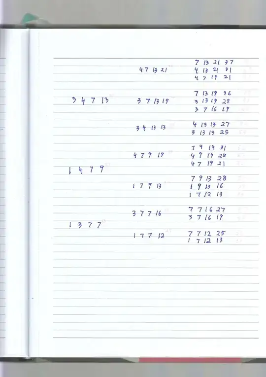

Alright, it all worked out. With $w \leq x \leq y \leq z$ a solution, we cannot have $w \leq x < 0 < y \leq z$ because $$ (w^2 - w x + x^2) + (y^2 - yz+z^2) = (w + x)(y + z). $$ This is a minor variant of an inequality on page 14 of Graham et al., link to arXiv above. Next, we cannot have $w = x + y + z = 0$ for a nontrivial solution, because $w = -(x+y+z)$ implies $3 (x^2 + y^2 + z^2 + yz+zx+xy ) = 0,$ but this is a positive definite form and thus $x=y=z=0$ and $w=0.$ Taking $w+x+y+z > 0$ as a hypothesis, the 1907 technique of Hurwitz on finding a Grundlösung ($w + x + y \geq 2 z$) with inequalities first give $w \geq 0,$ then $z=y=x$ and $w=0.$ In order to have the GCD turn into one we have $z=y=x=1.$
So, the whole thing really is a tree, single root, any solution can be reduced to $(0,1,1,1)$ in a finite number of steps(of the four types above), along with re-ordering at need.
Saturday: slight change, the thing is not quite a tree, although it remains a partially ordered set in which any (ordered) quadruple can be reduced to $(0,1,1,1)$ in a finite number of steps, each time strictly reducing $w+x+y+z.$ The surprise for me was that $(1,7,12,13)$ can reduced to either $(1,7,12,7),$ ordered $(1,7,7,12),$ or $(1,7,9,13),$ already ordered. Below are the first few layers of the poset, building off $(1,3,4,7):$
The first three dozen solution quadruples that reduce in two distinct ways, ordered by $w+x+y+z,$ are
