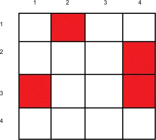

Use rook polynomials to count the number of permutations of $(1,2,3,4)$ in which $1$ is not in the second position, $2$ is not in the fourth position, and $3$ is not in the first or fourth position. How do we solve this one? Do we first calculate the rook polynomials of forbidden positions and then subtract?

  • The question doesn't mention any other thing but I think it's supposed to be 4 by 4 board and #1 cannot be in the second position of 1st row, 2 cannot be in the 4th position of 2nd row and 3 cannot be in the 1st or 4th position in 3rd row. I don't know if that helps. – user180588 Oct 03 '14 at 06:26

The easiest thing to do would be to draw out your diagram first. Given the information in the problem as stated, a reasonable chess board would be given as
Image of Chess board without re-ordering
For this chess board, the numbers on the left column represent the numbers to be permuted, the numbers along the top row represent the positions that a number can go to. A square that is shaded red is a forbidden region (for example, the square at row 1, column 2 is forbidden since you state in the problem description that the number 1 can not go to position #2).

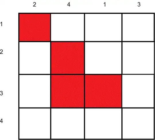

We can reorganize the columns to make a chess board that is easier to work with like the one below.

Because of the way I reordered the chess board, determining the rook polynomials for the forbidden regions is relatively easy.
The rook polynomial for the red square at row 1, column 2 is (1 + x). The rook polynomial for the other forbidden region is (1 + 3x + x2). Seeing as both of these regions are disjoint (meaning that neither region shares a row or a column), we simply multiply both polynomials together, yielding
1 + 4x + 4x2 + x3
We now use the Principle of Inclusion and Exclusion to count the number of possible arrangements where no number gets sent to a forbidden position.
Let rk be the coefficient of xk in the rook polynomial (1 + 4x + 4x2 + x3).
Without regard to forbidden positions, there are r0(4!) = 1 * 4! ways to permute the numbers.
We now subtract off the number of permutations where at least one number is in a forbidden position, given by r1(3!) = 4*3!.
But we subtracted off twice as many permutations with at least 2 numbers in forbidden positions, so we must add on one of each, given by r2(2!) = 4*2!.
In adding on the previous term, we have twice counted the number of permutations with 3 of the numbers in forbidden positions, so we must subtract off those permutations one more time, given by r3(1!) = 1*1!.
The final answer is given by (1 * 4!) - (4 * 3!) + (4 * 2!) - (1 * 1!).
We could simplify: (1 * 4!) - (4 * 3!) + (4 * 2!) - (1 * 1!) = 24 - 24 + 8 - 1 = 7.
There are a total of 7 ways to permute the numbers 1,2,3,4 such that 1 does not go to position #2, 2 does not go to position #4, and 3 does not go to position #1 or position #4.
