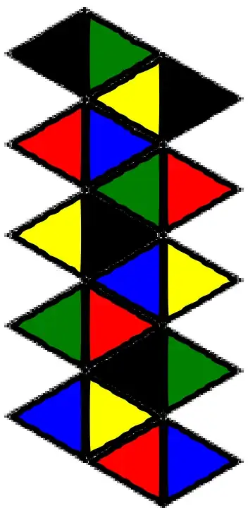

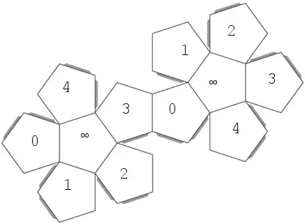

Geometric description: Both are isomorphic to the group of symmetries of the icosahedron/dodecahedron. To show this, I will five color the faces of the icosahedron, and label the faces of the dodecahedron with $\{ 0,1,2,3,4,\infty \}$, so the symmetry group acts on the $5$ colors by $A_5$ and acts on the $6$ elements of $\mathbb{P}^1(\mathbb{F}_5)$ by $PSL(2,5)$. Cutout out the two images below and tape them together to see the construction:
    Alternatively, there is a way (two, actually) to partition the vertices of a dodecahedron in groups of four in such a way that each part consists of the vertices of a regular tetrahedron. It is not difficult to see that a motion of the solid cannot give a transposition of two of the tetrahedra. – Mariano Suárez-Álvarez Mar 12 '12 at 19:16
    Yup. The colors here are vertices of the tetrahedra Mariano speaks of. I've always thought images of the tetrahedra were too cluttered to understand and that this might be clearer. It looked better in my head than on paper, though. – David E Speyer Mar 12 '12 at 19:20
  • Google will find modular origami instructions to build the five tetrahedra. It takes a little patience to fold the pieces and quite a bit of ingenuity to assemble, but the result is quite extraordinary. Drop by at my office if you are ever in the neighborhood and I'll let you play with mine :) – Mariano Suárez-Álvarez Mar 12 '12 at 19:24
    Feel free to edit in a photo of your desktoys! – David E Speyer Mar 12 '12 at 19:27
