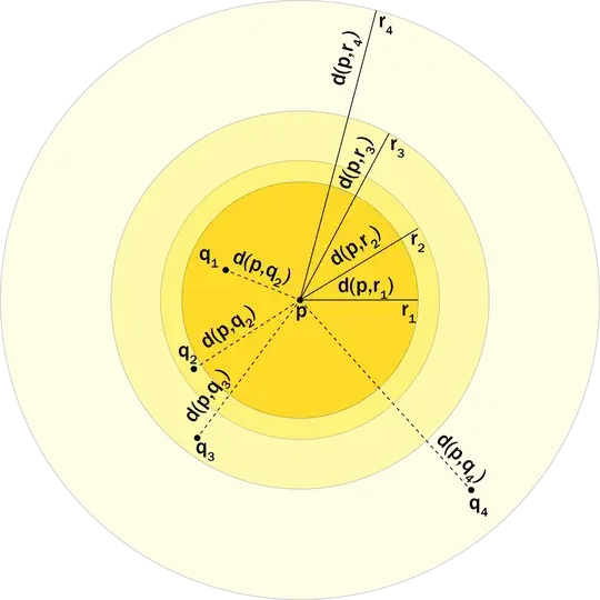

I have attached an image of how I was visualizing a limit point, but I'm now not so sure that I have understood the concept correctly after attempting to really draw out what I was visualizing.

I ran into a roadblock understanding the boundary, closure, and interior of halfspaces bounded by hyperplanes, and I think it runs back down to my misunderstanding of the limit point. Here is the figure I created: Limit Point
EDIT: New figure for a limit point $p$ New Limit Point Figure Please let me know if this is more accurate!
I am imagining this as happening at the "infinitesimal" level, so for example, $r_{1}$ is not actually as large as shown in the figure. The three general operations I imagine happen are:
$$d(r_{n},r_{n-1}) \rightarrow 0$$ $$\forall r \in \mathbb{R}, \exists q \in E \text{ }|\text{ } d(p,q_{n})<r_{n}, n \in \mathbb{N}$$ $$d(p,q_{1}) \rightarrow 0$$
So I think of every neighbourhood around the point $p$ as being circles of expanding radius, and have the condition that there must be some $q \neq p$ where $q \in N_{r}(p)$ and I think of this as being a condition for each radius. Is this an overcomplication? I realized that for say some $r_{1}$ that if there exists a $q \in E$ so that $d(p,q) < r_{1}$, then for any $r_{i} > r_{1}$, that same point $q$ which worked for the neighbourhood $N_{r_{1}}(p)$ will work for the neighbourhood $N_{r_{i}}(p)$. So, are these three operations sort of additional constraints on the situation that do not add any relevant information?

    The nhoods shouldn't be thought of as expanding, but rather contracting. As the radii of the nhoods tends to 0, you can still find points in $E$ distinct from $p$. Though the radius can be arbitrarily small, it is still positive, and there is "room" for the point $q$ (points take up no space). Note also that the $q$ may change depending on the nhood. – David Mitra Dec 21 '11 at 20:01
    I don't understand all of what you're saying, but here are at least some points: a) There seems to be a mistake in the second of your displayed equations; the dummy variable $r$ of the universal quantifier doesn't occur anywhere else. b) The "Main Question" appears to suffer from quantifier reversal -- it's not "there is a $q$ such that for all $r$" but "for all $r$ there is a $q$ such that". c) It's unusual to define a neighbourhood of $p$ as only open balls containing $p$ -- usually a neighbourhood is any set containing such an open ball (or in some texts, any open such set). – joriki Dec 21 '11 at 20:06
    I would perhaps visualize it as the point being "really close" to the set, since any neighbourhood of the point contains a point from the set. – Mikko Korhonen Dec 21 '11 at 20:07
  • I agree, quantifier order is important! – Dylan Moreland Dec 21 '11 at 20:07
  • P.S.: I just checked the book and it does have that definition of a neighbourhood -- just be aware that this is not the usual definition; see e.g. Wikipedia. – joriki Dec 21 '11 at 20:12
  • As Joriki points out, $p$ is a limit point of $E$ if for $each$ $r>0$, there is a point $q\ne p$ (that may be different from different $r$'s) in the the ball of radius $r$ centered at $p$. – David Mitra Dec 21 '11 at 20:13
  • I have corrected the sentence Joriki pointed out, I apologize for that. Thank you for pointing that out.

The problem seems to be that you’ve got your quantifiers backwards. It isn’t that there’s a single $q\in E$ such that $d(p,q)<r$ for arbitrarily small $r$. Rather, for each positive $r$, no matter how small, there is a $q\in E$ such that $d(p,q)<r$. The choice of $q$ depends on $r$. In symbols, this is the difference between
$$\exists q\in E\setminus\{p\}\;\forall r>0 (d(p,q)<r$$ and $$\forall r>0\;\exists q\in E\setminus\{p\}(d(p,q)<r\;.$$
For a simple example, let $$E=\left\{\frac1n:n\in\mathbb{Z}^+\right\}\;,$$ and let $p=0$. For $r=0.1$, you can take for $q$ any $1/n$ with $n>10$. With $r=0.01$, on the other hand, you’ll need to choose a $1/n$ with $n>100$. And so on.
I’d also say that your picture is inside-out: you should think of circles of decreasing radius squeezing in closer and closer to $p$. Then $p$ is a limit point of $E$ if within each of those circles, no matter how close to $p$, there is at least one point of $E$ different from $p$ itself.

    @Samuel: You’ve fixed the order of the written quantifiers, but not the way you’re thinking about them when you ask how two points can be distinct when you shrink the radius arbitrarily small. If it were always the same two points, obviously they couldn’t be distinct, but they’re not the same two points: as you shrink $r$, $q$ changes as well. – Brian M. Scott Dec 21 '11 at 20:53
