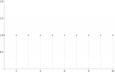

For example, if we sum $1$ number ($1$-$10$), the distribution looks like
$\hspace{3cm}$enter image description here

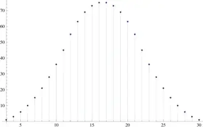

If we sum $3$ numbers ($1$-$10$), the distribution starts to looks like a normal distribution

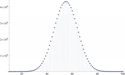

If we sum $10$ numbers ($1$-$10$), the distribution looks even more like a normal distribution

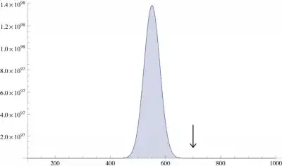

Now lets look at the sum of $100$ numbers ($1$-$10$)
The number of ways for $100$ numbers ($1$-$10$) to sum to $700$, which was computed in this answer, is pointed to by the arrow. Note that the range of the sum is $9n$ where $n$ is how many numbers are added; however, the standard deviation is $\sqrt{8.25n}$. Thus, the relative spread gets smaller; that is, the distribution becomes narrower about the mean as $n$ get bigger.
The maximum number of ways to sum to $T$ is at the mean of the distribution; that is, at $T=550$, where the number of ways is $$ 13868117806391314648666325510838589167047653141664\\4888545033078503482282975641730091720919340564340 $$ which is approximately $1.3868117806391314649\times10^{98}$.

  • Wow - you guys are amazing. I'm so dense I didn't even realise, of course the question is just equivalent to looking at the random distribution. one question - you see the final graph, in fact the answer to the question ........ – Fattie Sep 13 '14 at 09:30
  • ...... would we still call that "a bell curve," a normal distribution, since it's so incredibly pointy? As the answer explains, for 1 or 2 numbers, I guess you'd say, "it is not" a Normal distribution. Well now, when you get to very high numbers (300, 500, 10,000) again does it become "not" a Normal distribution? Or, is it still perfectly a "bell curve" but just very pointy? Is bell curvey -ness subjective? Or conversely, just by definition, is every result here officially a normal distribution (even the 1 or 2 cases)? Cheers!!!!! – Fattie Sep 13 '14 at 09:31
  • @JoeBlow: A scaled bell curve looks pointy, and that is what this is: a scaled bell curve. If scaled so that the standard deviation is $1$, its total sum is $1$, and translated so that the mean is $0$, it would look very close to a normal distribution bell curve. Scaled this way would map the total range of possibilities to the whole real line. – robjohn Sep 13 '14 at 09:39
  • Gotchya, I'll have to think about that. If I'm not mistaken, in your graphs, indeed they all start and end at the zero points (so, for "10" it's 10-->100, and for "100" it's 100-->1000 etc). And the scale heights are the same so there's no "trick". But it seems to me they are radically different: the shapes of "100" and "10million" would be terribly different right? Recall I was asking "is 700 just freakishly small for some reason?" Indeed, that is the reason: there is no such "freakish smallness" in the (say) "10" or "15" case when you are still equally near the middle .... but ... – Fattie Sep 13 '14 at 09:53
  • ... indeed this function becomes "amazingly pointy" as the count gets higher. I'm thinking like a video game programmer, if something depended on that shape, play would be spectacularly different with the "10" shape versus the "500" shape. (You'd almost always, versus never, run in to the goblin or whatever.) Anyways - I'm wasting your time - I'll go take a refresher course in normal curves THANK YOU SO MUCH. Do you often provide such good answers that nobody else even has to bother? ;-) – Fattie Sep 13 '14 at 09:55
