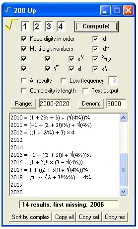

Many years ago, I wrote a simple Windows program called $200$ Up (link to Dropbox folder) for solving problems like these:
$\hspace{1.75in}$ 200 Up
The domain of calculation is $\mathbb{Z}/d$ for some specified denominator $d\in\mathbb{N}$ (and with limits on the magnitude of the numerator).
Note that, in the image above, the solution for 2018 is
$$ \large 2018 \;\;=\;\; \big( \sqrt[\sqrt{\cdot \dot{1}}]{\Large 2} \; + \; 3!!\%\% \big) \; \div \; \cdot 4\%. $$

    I don't care whether or not percentages are allowed -- this makes me just as happy as the construction using 1 to 5 I quoted above. And you do 2012 too! What happens if you take percentage off and then search again for 2011? – Kevin Buzzard Dec 21 '11 at 19:10
  • @KevinBuzzard: No solution is found for $2011$ without percentages. With the rules as specified, the only solutions found for this century are $2016 = (1 + 2)!! + 3!^4$ and $2088 = (1 + 2) \times (3!! - 4!)$. If the digits don't have to remain in order, we also have $2024 = 4!! \div (21! \times 3!)$ and $2048 = 2^{13} \div 4$. – David Bevan Dec 21 '11 at 19:57
    Percentages give great power. For example here's how to create $97$ from four $0$s: $$97 = \big(\sqrt{0!%} - \sqrt{\sqrt{0!%} - 0!%},{\Large %}\big) \div \sqrt{0!%},{\large %}.$$ – David Bevan Dec 21 '11 at 20:35
