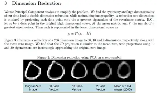

I am trying to write a program that will perform OCR on a mobile phone, and I recently encountered this article :
article excerpt
Can someone explain this to me ?

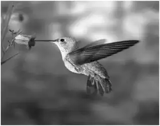

Consider the following grayscale image of a hummingbird (left). The resulting image is a $648\times 600$ image of MATLAB doubles, which takes $648\times 600\times 8=3110400$ bytes.

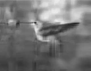

Let's look at what information is actually contained in the different singular values. The figure on the left below shows the image recreated from the first 10 singular values ($l=10$ in J.M.'s answer). We see that the essence of the picture is basically captured in just 10 singular values out of a total of 600. Increasing this to the first 50 singular values shows that the picture is almost exactly reproduced (to the human eye).

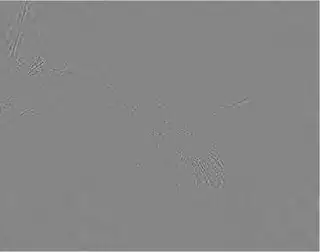

So what exactly do the smaller singular values contain? Looking at the next 100 singular values (figure on the left), we actually see some fine structure, especially the fine details around the feathers, etc., which are generally indistinguishable to the naked eye. It's probably very hard to see from the figure below, but you certainly can in this larger image.

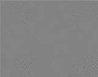

The smallest 300 singular values (figure on the right) are complete junk and convey no information. These are most likely due to sensor noise from the camera's CMOS.

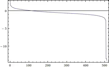

In brief, the $512\times 512$ example image can be obtained through ImageData[ColorConvert[ExampleData[{"TestImage", "Lena"}], "Grayscale"]]. A plot of $\log_{10} \sigma_k$ looks like this:
log singular values of Lenna
