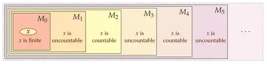

Update. I wrote an extended essay on Skolem's paradox on Infinitely More. What I show there by the end is that there can be a tower of models of set theory, with a set in common that is thought to be finite in the first model, then uncountable, then countable, then uncountable again, then countable, and so forth, in a pattern as long as desired. enter image description here
