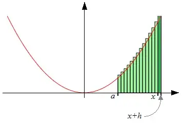

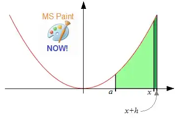

Suppose that $A(x)$ represents the area under the curve $f$ between $a$ and $x$. Now try to find A'(x) with limits. $$A'(x)=\lim_{h\to 0} \frac{A(x+h)-A(x)}{h}$$
Now try graphing $A(x)$ and $A(x+h)-A(x)$ as shaded regions under the graph of $f$, where $A(x+h)$ is the union of the $A(x)$ and $A(x+h)-A(x)$ regions. enter image description here
I think that you will find that $$A(x+h)-A(x)\approx hf(x+h)\approx hf(x)$$ where $hf(x+h)$ is the area of an approximating rectangle. The limit then becomes $$A'(x)=\lim_{h\to 0} \frac{hf(x+h)}{h}=f(x)$$
