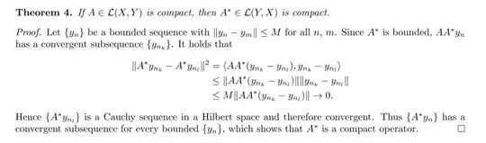

Here is an answer using the idea that Cauchy sequences are convergent in complete spaces.
