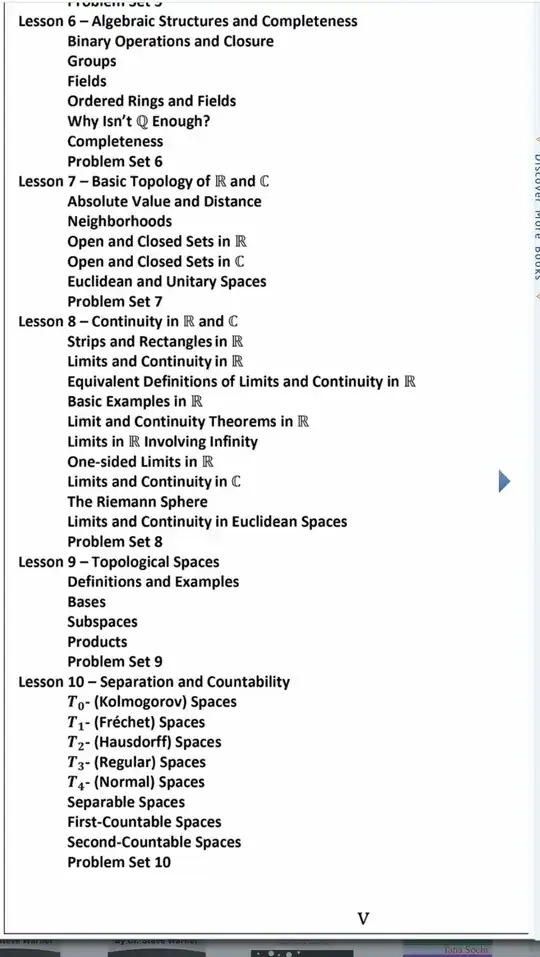

enter image description hereTopology For Beginners by Steve Warner It starts with Set theory and goes from there. It ends with Algebraic topology
