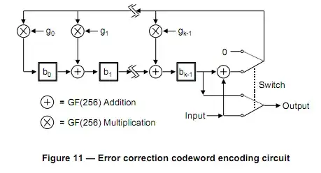

I am attempting to generate QR codes on an extremely limited embedded platform. Everything in the specification seems fairly straightforward except for generating the error correction codewords. I have looked at a bunch of existing implementations, and they all try to implement a bunch of polynomial math that goes straight over my head, particularly with regards to the Galois fields. The most straightforward way I can see, both in mathematical complexity and in memory requirements is a circuit concept that is laid out in the spec itself:
circuit diagram
With their description, I am fairly confident I could implement this with the exception of the parts labeled GF(256) addition and GF(256) Multiplication.

For your purposes, the elements of $GF(256)$ are polynomials in $x$ of degree $\le 7$ with coefficients in $GF(2)$. $GF(2)$ is just $\{0,1\}$ with binary addition and multiplication, but there are no carries: 1+1=0 in $GF(2)$.
So for example, $x^4 + x^3 + 1$, $x^7 + x^2 + x$, $x^5 + x^3 + 1$, are all elements of $GF(256)$. There are 256 elements in all (hence the name $GF(256)$).
Addition of 2 polynomials in $GF(256)$ is straightforward. For example: $(x^4 + x^3 + 1) + (x^3 + x^2 + 1) = x^4 + x^2$. This is just normal addition of polynomials, but the coefficients of the calculations take place in $GF(2)$. So when I added the 2 $x^3$ terms together, the coefficient became 1+1=0 (so the $x^3$ term disappeared altogether). As bit sequences this would be: 11001 + 1101 = 10100. This is straightforward to implement in most programming languages: It's just an XOR of the bit sequences.
To multiply 2 polynomials in $GF(256)$, first you multiply the polynomials just like ordinary polynomials but again, remembering that the calculations take place in $GF(2)$. Then divide the result by $x^8+x^4+x^3+x^2+1$ and take the remainder. Unlike addition, this is less straightforward to implement from scratch. (You can't use the usual multiplication operator in your programming language to do the multiplication, because ordinary multiplication has carries, but $GF(2)$ does not.)
See the example here which is a slightly different polynomial (they use $x^8+x^4+x^3+x+1$ instead of $x^8+x^4+x^3+x^2+1$), but it's the same process. There is also a description of a multiplication algorithm there (you'll have to change it slightly for your polynomial).

To add to Ted's answer, depending on the capabilities of your platform, the XOR of bit sequences that implements addition in GF$(256)$ might be implementable as the XOR of bytes; often available as a machine instruction, even on simple processors.
On the other hand, implementing the multiplication of two elements of GF$(256)$ as multiplication of two polynomials and then taking the remainder modulo $x^8+x^4+x^3+x^2+1$ is very time-consuming. I recommend you read an excellent tutorial description by @Jyrki Lahtonen. If you have memory available, Galois field multiplication can be implemented via log tables. See here for a description of log tables, and do follow all the links there to get some ideas on how to speed up things.
Edit: added new material on multiplication
Suppose that we want to multiply binary polynomials $c(x) = \sum_{i=0}^7 c_ix^i$ and $d(x) = \sum_{i=0}^7 d_ix^i$, and find the remainder after dividing the result by $m(x) = x^8+x^4+x^3+x^2+1$, that is, we want to compute $c(x)d(x)\bmod m(x)$. Sometimes it is convenient to embed the division by $m(x)$ into the multiplication process, and this idea can be particularly useful in the encoder figure shown in the question in which one polynomial (the one being fed back in the top line of the figure) is to be multiplied by $k$ different (fixed) polynomials $g^{(i)}(x), 0 \leq i \leq k-1$. We have $$\begin{align*} e(x) &= c(x)d(x) \bmod m(x)\\ &= \left(\sum_{i=0}^7 c_ix^i\right) d(x) \bmod m(x)\\ &= \left[c_0d(x) + c_1xd(x) + c_2x^2d(x) + \cdots + c_7x^7d(x)\right] \bmod m(x)\\ &= c_0d(x) + c_1[xd(x)\bmod m(x)] + c_2[x (xd(x)\bmod m(x))\bmod m(x) ]+\cdots\\ &\quad\quad\quad\quad\quad\quad\quad \cdots + c_7[x(x^6d(x)\bmod m(x)) \bmod m(x)]\\ &= \sum_{i=0}^7 c_if^{(i)}(x) \end{align*}$$ where $f^{(0)}(x) = f(x)$ and $f^{(i)}(x) = xf^{(i-1)}(x) \bmod m(x) = x^id(x) \bmod m(x)$. Note that the $c_i$ are $0$ or $1$. So, $e(x)$ is initialized to the zero polynomial and then if $c_0 = 1$, $d(x)$ is added to $e(x)$. Then, if $d(x)$ is not needed any more (it is not in the QR code application being considered here), it is replaced by $$xd(x) \bmod m(x) = \sum_{i=0}^7 d_ix^{i+1} \bmod m(x) = \sum_{i=0}^7 (d_{i-1}\oplus d_7m_i)x^{i}. $$ If $d(x)$ is needed elsewhere, this operation is carried out on the copy that has been called $f(x)$. Next, if $c_1 = 1$, the new $d(x)$ is added to the sum being accumulated in $e(x)$ and the new $d(x)$ replaced by $xd(x) \bmod d(x)$, etc. In short, the following two-step process is executed for $k = 0, \ldots , 7$.
  • If $c_k = 1$, $e(x):= e(x) + d(x)$
  • $d(x) := \sum_{i=0}^7 (d_{i-1}\oplus d_7m_i)x^{i}$
to complete the GF$(256)$ multiplication in eight iterations of the two-step process.
There are two advantages of this approach for the QR code application First, if $d(x)$ is chosen to be the polynomial being fed back and $c(x)$ one of the $g^{(j)}(x)$, then the coefficients of $c(x)$ are fixed and known ahead of time, and so the first of the two steps above can be simplified. Second, since the same $d(x)$ is being used to multiply $k$ different $g^{(j)}(x)$'s, the update of $d(x)$ can be shared among the $k$ different multiplications if they are arranged to proceed in parallel instead of one by one. Also, as a minor improvement, since the product $e(x)$ is to be added to a $b(x)$, $e(x)$ can be initialized to have value $b(x)$ instead of the zero polynomial.
Dilip Sarwate
  • 25,197
  • +1 Nice, as expected. I was left wondering, whether there is a half-way point between using the long division and the discrete log table, where we store a LUT containing the presentations for the "overflowed" powers of $x$, here $x^8,x^9,\ldots,x^{15}$, and use those instead of the "shift and XOR" approach. I gave up on that because I'm not sure about the complexity, and mostly because it won't do away with the need to use 16-bit registers (ok, 15 would do) to store intermediate results. Here it looks like you may get away with 9-bit registers (or 8, if the processor has an overflow flag). – Jyrki Lahtonen Dec 09 '11 at 19:02
  • @Jyrki Thanks. You say "Here it looks like you may get away with 9-bit registers (or 8, if the processor has an overflow flag)." The ability to shift a byte left is also important, and if an overflow flag is not available, one can make do with testing $d_7$, shifting left, and then XORing in $m$ if $d_7$ previously was a $1$. – Dilip Sarwate Dec 10 '11 at 03:00
