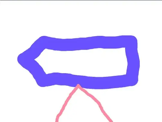

So, let me draw some diagrams.
The above works fine, because that is the default rotation of the ship, and so the red ship can easily collide.

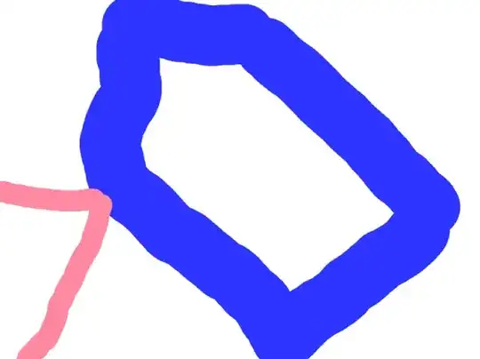

However, enter image description here if the ship is rotated at an angle like that, I cannot work out how to have the same or similar line of code but still have it working.
Sure, I know my rotation matrices, however either I am just being dumb or I don't see how they help here.

  • What exactly are distancex and distancez? "The distance from one ship to another" is ambiguous, because it depends which reference points you use on the ships. The centers? The corners? Also, what are the dimensions of the ships? – Jack M Aug 10 '14 at 09:59
I'd say you should not rotate the ship itself, rotate the whole world (or the coordinate system) so that the ship is again in the same orientation as in the first image. In the first image the ship points into the diretion of $a = (-1,0)^t$ (The $^t$ means just that I wrote a row vector but I mean a column vector.) In the 2nd image it is roughly in direction of $b = \frac{1}{\sqrt{2}} (-1,1)^t$. The angle between those is $\alpha = \cos^{-1}\left( \frac{\langle a,b\rangle}{\vert a \vert \cdot \vert b \vert} \right) $ where $\langle a, b \rangle = a_1b_1+a_2b_2$ is the standard scalar product of two 2-dimensional vectors, and $\vert a \vert = \sqrt{a_1^2+a_2^2}$ is the length (norm) of the vector. Now for rotating vectors we can use a rotation matrix:
$$ v_{rot} = \begin{pmatrix} \cos(\alpha) & -\sin(\alpha) \\ \sin(\alpha) & \cos(\alpha)\end{pmatrix} \cdot v = \begin{pmatrix} \cos(\alpha) v_1 - \sin(\alpha) v_2 \\ \sin(\alpha) v_1 + \cos(\alpha) v_2\end{pmatrix}$$
So in our case $$ a = \begin{pmatrix} \cos(\alpha) & -\sin(\alpha) \\ \sin(\alpha) & \cos(\alpha)\end{pmatrix} \cdot b = \begin{pmatrix} \cos(\alpha) b_1 - \sin(\alpha) b_2 \\ \sin(\alpha) b_1 + \cos(\alpha) b_2\end{pmatrix} = \begin{pmatrix} \frac{1}{\sqrt{2}} \frac{-1}{\sqrt{2}} - \frac{1}{\sqrt{2}} \frac{1}{\sqrt{2}} \\ \frac{1}{\sqrt{2}}\frac{-1}{\sqrt{2}}+\frac{1}{\sqrt{2}}\frac{1}{\sqrt{2}}\end{pmatrix} = \begin{pmatrix} -1 \\ 0 \end{pmatrix}$$
If you now have the true distance vector $d = (d_1, d_2)$ between the two ships, you can apply the same rotation to $d$ and get $d_{rot}$ and then apply your normal collision check on the vector $d_{rot}$, so:
$$ d_{rot} = \begin{pmatrix} \cos(\alpha) & -\sin(\alpha) \\ \sin(\alpha) & \cos(\alpha)\end{pmatrix} \cdot d = \begin{pmatrix} \cos(\alpha) d_1 - \sin(\alpha) d_2 \\ \sin(\alpha) d_1 + \cos(\alpha) d_2\end{pmatrix} $$
PS: If the two ships are not in a nice right angle relative to each other, I'd calculate the four corners of the box of one ship (and not the distance which is - I assume - just the distance to the center of each ship), and check whether they are within the box of the other ship using the mentioned method.
