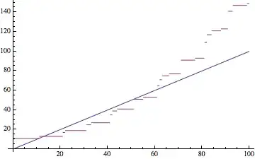

Define the function $f$ to be $$f(x) = C + \sum_{j = 1}^N \left\lfloor \frac{x}{P_j} \right\rfloor C_j.$$ We are trying to solve $$Q = f(Q)$$ which is a fixed point equation. The function $f$ is monotonically increasing. To get some feel for it, let's consider the example $C = 11$, $N = 10$, $P_j = 10 j + 1$ and $C_j = 2 j$. We draw the graph of $y = f(x)$ and $y = x$, and observe where they intersect (magenta is $f$):
graph of f
As you see, there are several solutions. There is a well-known method for finding fixed points of functions:
  1. Start with an arbitrary approximation, say $X_0 = 0$
  2. Define $X_{k+1} = f(X_k)$
  3. Keep computing $X_0$, $X_1$, $X_2$, ... until you get $X_{k+1} = X_k$, or at least $|X_{k+1} - X_k| < \epsilon$ for an acceptably small $\epsilon$.
There is no guarantee the process will actually find a fixed point, but at least in our case it does, we get: $X_0 = 0$, $X_1 = 11$, $X_2 = 13$, $X_3 = 13$, so $X = 13$ is a solution. Depending on what your $P_j$ and $C_j$ look like this method may work well.

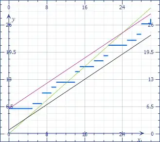

Given that $x-1<\lfloor x\rfloor\le x$, we have this bracketing for $S$: $$C+Q\sum_{j=1}^N\frac{C_j}{P_j}-\sum_{j=1}^NC_j<S=C+\sum_{j=1}^N\lfloor\frac Q{P_j}\rfloor C_j\le C+Q\sum_{j=1}^N\frac{C_j}{P_j}.$$
By equating the bounds (magenta and black lines) to $Q$ (green), you get a good estimate of the range where solutions can be found. (If you start from a nonzero $Q$, you can initialize $k_j=\lfloor\frac Q{P_j}\rfloor$.)
