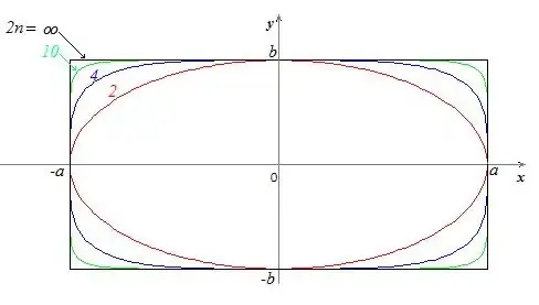

A curious equation : $$\lim_{n \to \infty}\left({\left(\frac{x}{a}\right)^{2n} + \left(\frac{y}{b}\right)^{2n}}\right) = 1$$ For $-a<x<a$ then $\frac{x^2}{a^2}<1$ then $\left(\frac{x^2}{a^2}\right)^\infty=0$. Hense $\frac{y^2}{b^2}=1$ . So $y=b$ or $y=-b$ which gives the upper and the lower sides of the rectangle.
For $-b<y<b$ then $\frac{y^2}{b^2}<1$ then $\left(\frac{y^2}{b^2}\right)^\infty=0$. Hense $\frac{x^2}{a^2}=1$ . So $x=a$ or $x=-a$ which gives the right and the left sides of the rectangle.
http://mathworld.wolfram.com/Superellipse.html
http://mathworld.wolfram.com/Rectellipse.html
