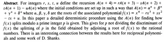

You may find of interest the paper below, which refers to the pertinent theory and also presents an algorithm to compute the splitting type of quartics over $\:\mathbb F_p\:.\:$
Adams, William W. Splitting of Quartic Polynomials, Math. Comp. 43 167 (1984) 329-343.
Bill Dubuque
