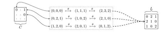

The less common notation is useful in some cases, e.g.:
  • Let $\alpha$ be a permutation. Let $\alpha'$ be the map defined by $\alpha(i) \overset{\alpha'}{\longmapsto} i$. We see that $i \overset{\alpha}{\longmapsto} \alpha(i) \overset{\alpha'}{\longmapsto} i$ and $\alpha(i) \overset{\alpha'}{\longmapsto} i \overset{\alpha}{\longmapsto} \alpha(i)$, and so $\alpha\alpha'=\alpha'\alpha$ is the identity map.
  • If $\theta$ is a permutation of a group $(G,+)$, then $\theta$ is an orthomorphism if $g \mapsto \theta(g)-g$ is also an permutation of $G$.
Here's an image from a paper I'm currently writing where I use the notation element-by-element:
In this example, it would be cumbersome to use e.g. $\theta\big((0,0,0)\big)=(1,1,1)$ and $\theta^2\big((0,0,0)\big)=(2,2,2)$.
