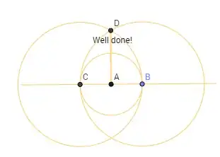

I've been playing Euclid: The Game for some time now. I'm quite addicited to it, trying to get all the records now. Suprisingly, I'm not able to get a record for some really early level. In Level 4 (http://euclidthegame.com/Level4/), I'm trying to get the record for primitive tools. Primitive tools means that you can only use the first 5 tools (compass and straigthedge), and not any tool that you unlock in later levels.
The current record is 3 moves, but I really don't get how that could be possible. The best I can do is 4 moves.
  1. Create a random point on the line B
  2. Create a circle with center A and radius AB.
  3. Create a point at the intersection of the line and the circle
  4. Create a circle with center C and radius BC
  5. Create a circle with center B and radius BC
  6. Create a point at the intersection of the circles (D)
  7. Craete the segment AD.
Point creation is not counted as a move, so this is 4 moves, but how can you do this possibly in 3 moves ?
