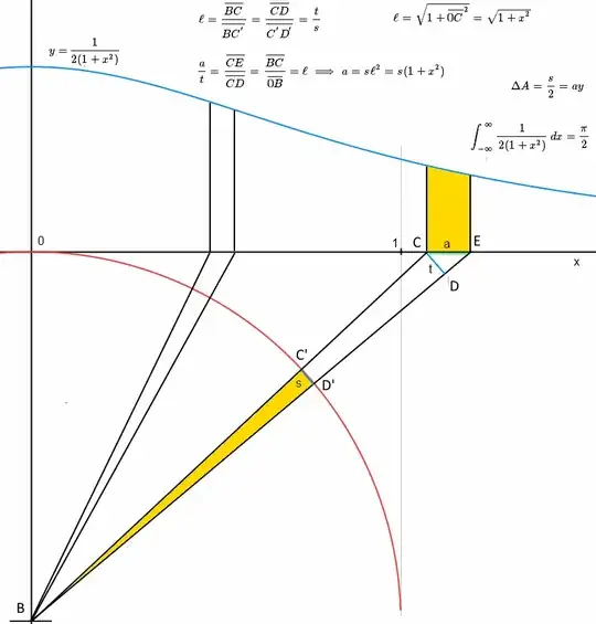

Step 1 admits several visual-geometric proofs (below I insert a diagram I made for the linked question, that shows the area equivalence for the full graph: $\int_{-\infty}^{\infty}1/(1+x^2) dx =\pi$; just trim it to the $[0,1]$ range).
But steps 2 and 3, though elementary from a analysis point of view, do not seem easy to visualize.
Explanation added by comment request: the graph (edited) intends to show that the two areas in yellow are (asymptotically) equal.
First, we have a circular sector with radius 1 and arc $s$, which is approximated by a triangle with the same height and base ; hence its area is $s/2$.
The other area is below the function $\frac{1}{2(1+x^2)}$, so its area is $ \overline{CE} \times y = a \frac{1}{2(1+x^2)}$. We then compute $a$:
Because $B0C$ is rectangular $\ell=\overline{BC}=\sqrt{1+\overline{0C}^2}=\sqrt{1+x^2}$
Because triangles $CDB$ and $C'D'B$ are similar, $\ell=\frac{\overline{BC}}{\overline{B C^{'}}}=\frac{\overline{CD}}{\overline{C^{'}D^{'}}}=\frac{t}{s}$
Because $CED$ and $BOC$ are similar $\frac{a}{t}=\frac{\overline{CE}}{\overline{CD}}=\frac{\overline{BC}}{\overline{0B}}=\ell$
Hence $a= s \ell^2 = s (1+x^2)$ and the area is also $s/2$.
Applying this to the range $[0,1]$ we deduce that the area of an octave of a unit circle equals $\int_0^1 \frac{1}{2(1+x^2)}dx$

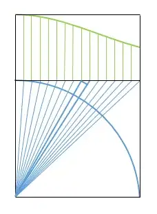

In the figure below, we have drawn a quarter circle inside a unit square and divided the top side in $n$ equal parts. Then we have chosen the height of the blue rectangles in such a way that the area of a rectangle equals the area of the corresponding sector (the aperture angles go decreasing).
If you look at the enhanced triangle, its long sides have length $\sqrt{1+x^2}$, by Pythagoras, so that its short side is $\sqrt{1+x^2}$ times longer than the arc on the circle ($x$ horizontal in $[0,1]$). Then by similarity of triangles, the ratio of the width of a rectangle to this short side is also $\sqrt{1+x^2}$, and we conclude that the equation of the green curve is
$$y(x)=\frac1{2(1+x^2)}.$$
Furthermore, the area under the curve is the same as the area of the eighth of a circle, i.e. $\dfrac\pi8$.
Now the (doubled) area is obtained as the sum of the areas of the rectangles,
$$\frac\pi4=2\sum_{k=1}^n\frac1ny\left(\frac kn\right)=\frac1n\sum_{k=1}^n\frac1{1+\dfrac{k^2}{n^2}}.$$
