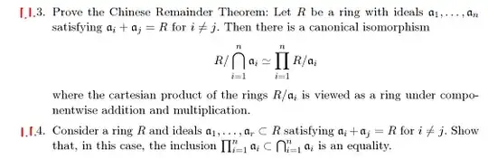

Here is the problem:
and the two problems it refers to:
