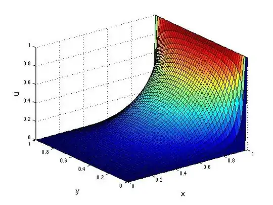

I have come up with a simpler equation while formulating my question.
Idea is to interpolate between X and Y axis proportionally to distance to them.
Let me guide you through with an example:
// Input
X = 0.5; Y = 0.1
// This is base interpolation that prefers closer edge
x = A * (1-Y) + B * X + C * Y + D * (1-X); // Sum = 2
// Now calculate proportion between distances to edges
distX = 0.5 - Abs(X-0.5); // Distance to edge 0..0.5 range
distY = 0.5 - Abs(Y-0.5); // Distance to edge 0..0.5 range
if distX + distY > 0.001 then //0.001 is to deal with FP precision loss
begin
  distSum = distX + distY;
  coefX := distX / distSum; // 0..1 range
  coefY := distY / distSum; // 0..1 range
end
else
begin
  coefX := 0.5;
  coefY := 0.5;
end;
// Our example values
coefX = 0.5 / 0.6 = 0.83
coefY = 0.1 / 0.6 = 0.17
// Add X/Y weights into equation, to get Sum = 1
x = A * (1-Y) * coefX + B * X * coefY + C * Y * coefX + D * (1-X) * coefY;
x = A * 0.747 + B * 0.085 + C * 0.083 + D * 0.085; // Sum = 1
Sorry I'm not familiar with Excel formulas close enough to build a diagram, but it looks much alike this:
Benefits are: no need for iterations, knowing ABCD values and X Y position of x is enough.
