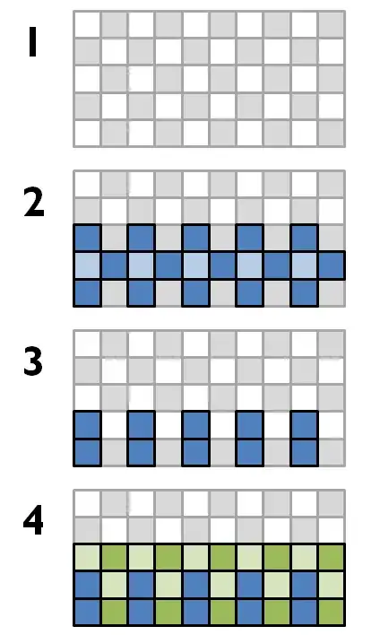

My colleague, Ido Segev, pointed out that there is a problem with most of the elegant proofs here - Tetris is not just a problem of tiling a rectangle.
Below is his proof that the conjecture is, in fact, false.

Gilad Naor

    It seems, in light of this counterexample (+1 btw), that the conjecture could be refined to improve the notion of "number of pieces" involved in a perfect clear, where the involvement of partial pieces was made more explicit. Although I wonder if allowing partial pieces makes for too many degenerate cases, destroying the hopes for any meaningful conjecture about partial piece perfect clears. – Greg L Nov 10 '11 at 18:43
    @Graphth Would someone explain the picture Gilad has shown and how this answers Eric's question? –  Dec 14 '11 at 00:32
    @SivaramAmbikasaran The question is, can we have an odd number of T pieces at the time that everything is cleared. The pictures show that if you start with 5 Ts and then 5 Ls, and play them just right, you will have a perfect clear. So, this answers the question, yes, it is possible to have an odd number of Ts before a perfect clear. – GeoffDS Dec 14 '11 at 01:08
  • @Graphth: Thanks. I got it. –  Dec 14 '11 at 01:20
  • I don't get what Gilad is telling in his answer, so could please someone explain ? I can see the T's with the points to the right in step 2, but I don't see what step 3 and 4 are about... Thanks in advance – Saryk Oct 09 '13 at 08:51
    @Saryk In step 2 the second row from the bottom is completely filled and as such gets cleared. In step 3 we see the remains of the T pieces (just the top and the bottom parts of the pieces with the middles cleared out). In step 4 the gaps are filled with L pieces to make a perfect clear. – SamYonnou Oct 11 '13 at 12:27
