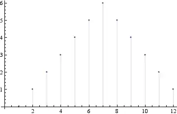

The number of ways for $2$ dice to sum to $n$ is obviously $0$ for $n<2$ and $n> 12$. For the others, think about how many different numbers that appear on the first die allow you to create a sum of $n$ with the numbers on the other die. For $7$, as an example, no matter what you roll on the first die there is a way to make seven with the other die. For $6$, however, you can't roll a $6$ on the first die and then get a total of $6$ on both dice.
Since for a given number on the first die there is at most one way to make the desired sum with the other die, counting this will give the desired result. It's easy to see that if $n \le 7$ the number is $n-1$ and if $n > 7$ the number is $13 - n$.
Plotting this comes out very nicely:
