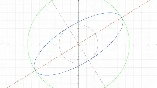

enter image description here First you should sketch a picture of your ellipse. The major axis lies along the line with equation: $ y = \frac{\sqrt{5} - 1}{2} x $
The minor axis will be perpendicular to the line of the major axis.
To find the length of the semi-major axis , find the distance between a point on intersection of the line above with the ellipse and the origin . Likewise the length of the semi-minor axis will be the distance between the point of intersection of the second line with the ellipse and the origin. I obtained this value by finding the maximum of x^2 + y^2 on the ellipse, ( this can be done in many ways, one is the method of lagrange multipliers.)
I'll include my sketch. You can take it down off the screen for a closer look. In regard to rotation of the axis, find the angle the red line makes with the x-axis , this will give you a good idea of what to try in terms of rotating your coordinate system.
Alan
  • 2,239
  • How did you derive the equation (slope) for the major axis? – John Alexiou May 12 '14 at 13:14
  • By finding the maximum value of $x^2 + y^2 $ on the ellipse: $x^2 + 2y^2 - 2xy = 1 $ and setting up the (green) circle in my sketch. In short, the Lagrange multiplier method. Every other fact about the ellipse then follows. – Alan May 12 '14 at 14:06
