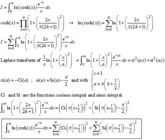

The result given in attachment is not a closed form : The aim is only to transform the integral into a series. The Laplace transform appearing in the calculus comes from H. Bateman,Tables of Integral Transforms, p.49 , Eq.17. Mc.Graw-hill Edit. (1954)
Numerical computations show that the convergence of the series given by Robjohn is faster than the convergence of my series. So, I advice to use the Robjohn's series instead of mine.
