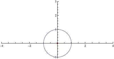

The equation for an ellipse with a focus at $(0,0)$ and the other at $(0,2ae)$ keeping $a(1-e)=f$ (where $f$ is distance from the vertex to the focus of the ellipse, which ends up being the focal length of the parabola) is $$ \frac{x^2}{a^2(1-e^2)}+\frac{(y-ae)^2}{a^2}=1 $$ which is equivalent to $$ \frac{x^2}{f(1+e)}+\frac{y^2-2aey}{a}=f(1+e) $$ If we let $a\to\infty$ (and therefore $e=1-\frac fa\to1$), we get $$ y=\frac{x^2}{4f}-f $$ which is a parabola.
$\hspace{3.4cm}$enter image description here

    Following on this line-of-thought, an hyperbola is a ellipse which had its focal point "wrap-around" at infinity and then come back from the other side? – NothingsImpossible May 03 '14 at 00:40
  • 41
    @NothingsImpossible: indeed – robjohn May 03 '14 at 11:36
    With $a \to \infty$, in the last step you simplify the term $y^2 / a$, considering this term as $0$. Why? There are some points still belonging to the ellipse where $y$ approaches infinity, so it may be comparable with $a$. This, in particular, happens at the opposite vertex. Why then is it possible to consider $y^2 / a \to 0$? – BowPark Sep 30 '19 at 11:47
    @BowPark: Of course, an ellipse is never actually a parabola. However, all points on the ellipse within a given distance of the origin (which is what we can "see", that is, plot), do tend to points on the given parabola. For $|(x,y)|\le R$, we have $\frac{y^2}a\le\frac{R^2}a\to0$. – robjohn Sep 30 '19 at 13:49
    If we had a league for Best Posts here, I would have voted to nominate this Post based on those two succinct illustrations (animation/GIF); it's something that I've almost never come across as a frequent visitor of the SE network for approximately five years. As long as we have qualified and dedicated members, I believe that more such visualizations would substantially add to the excellent content quality of our community. – Ardent Coder Apr 21 '23 at 09:51
