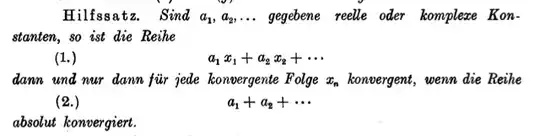

In modern terms, Schur starts out by identifying $\ell^1$ as the dual space of $c$, the space of convergent sequences via the pairing $\langle \mathbf{a},\mathbf{x}\rangle_{\ell^1, c} = \sum_{n=1}^{\infty} a_n x_n$:
Hilfssatz von Schur
Auxiliary Theorem. For a real or complex sequence $(a_n)_{n \in \mathbb{N}}$ the sum
$$a_1x_1 + a_2x_2 + \cdots$$
converges for each convergent sequence $(x_n)_{n=1}^{\infty}$ if and only if the series
$$a_1 + a_2 + \cdots$$
converges absolutely.
The proof is a rather immediate consequence of Abel's summation criterion.

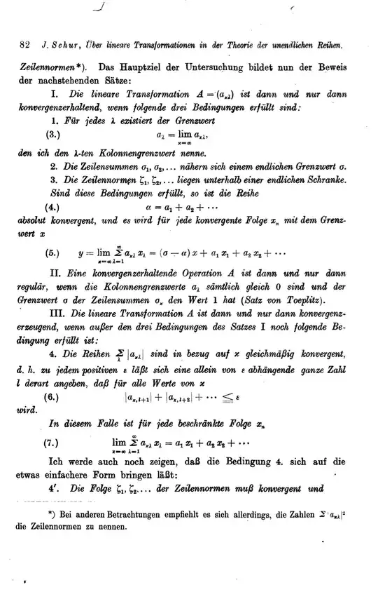

Consider a sequence $(\mathbf{a}_{n})_{n =1}^{\infty} \subset \ell^{1}$, where $\mathbf{a}_{n} = (a_{n1}, a_{n2}, \ldots)$. Let $c$ be the space of convergent sequences. Note that for each sequence $(\mathbf{a}_n)_{n=1}^{\infty}$, we get a linear map $A: c \to \mathbb{R}^{\mathbb{N}}$ given by $$A\mathbf{x} = (\langle \mathbf{a}_1, \mathbf{x}\rangle, \langle \mathbf{a}_2,\mathbf{x}\rangle, \ldots).$$ Schur seeks to determine necessary and sufficient conditions to ensure that $A$ defines a linear map $c \to c$ (he calls such maps convergence-preserving: they map convergent sequences to convergent sequences).
The necessary and sufficient conditions are (part I of the Hauptsatz on page 82):
The sequence $(\mathbf{a}_{n})_{n=1}^{\infty}$ defines a linear map $A: c \to c$ if and only if
  1. For every $k$ the limit $a_{k} = \lim\limits_{n\to\infty} a_{nk}$ exists.
  2. Put $\sigma_{n} = \sum_{k=1}^\infty a_{nk}$ then $\sigma_n$ converges to some $\sigma \in \mathbb{R}$.
  3. There exists aconstant $C$ such that for all $n$ we have $\|\mathbf{a}_{n}\|_1 \leq C$.
Moreover, if these conditions are satisfied then $\mathbf{a} = (a_k)_{k=1}^{\infty} \in \ell^1$ and putting $a = \sum_{k=1}^{\infty} a_k$ we have $$\lim_{n \to \infty} \langle \mathbf a_n, \mathbf x\rangle = (a-\sigma)\lim \mathbf{x} + \langle \mathbf a, \mathbf x\rangle,$$ in particular $\mathbf a_n \to \mathbf a$ in the weak$^{\ast}$-topology, if we identify $\ell^1 = (c_{0})^\ast$.
The second question Schur asks is: when does a sequence $(\mathbf{a}_n)_{n=1}^{\infty} \subset \ell^1$ induce an operator $\ell^{\infty} \to c$? The formula is again $A: \ell^{\infty} \to \mathbb{R}^{\mathbb{N}}$ and $$A\mathbf{x} = (\langle \mathbf{a}_1, \mathbf{x}\rangle, \langle \mathbf{a}_2,\mathbf{x}\rangle, \ldots)$$ for $\mathbf{x} \in \ell^{\infty}$ (he calls such operators $A$ convergence-generating). Since $A$ as above induces in particular an operator $A: c \to c$, the above conditions must be satisfied, so the condition must certainly be stronger. Indeed, part III of the Hauptsatz on page 82 reads:
In the above notation $A$ defines a linear map $\ell^{\infty} \to c$ (in particular the sequence $\mathbf a_n$ converges weakly to $\mathbf a$) if and only if for every $\varepsilon > 0$ there exists $l$ such that $\sum_{k=l+1}^{\infty} |a_{nk}| \lt \varepsilon$.

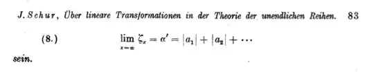

In the course of the proof he establishes that $\|\mathbf{a}_n - \mathbf{a}\|_{1} \;\xrightarrow{n\to\infty} \; 0$, so he shows that weak convergence implies norm convergence, as desired. To prove this, he proceeds by contradiction (see §4, p.89f). One easily reduces to the case that $\mathbf{a} = 0$ and, assuming that $\|\mathbf a_{n}\|_{1} \not\to 0$, he builds a bounded sequence $\mathbf{x}$ for which the sequence $A\mathbf{x} = (\langle \mathbf{a}_1, \mathbf{x}\rangle, \langle \mathbf{a}_2,\mathbf{x}\rangle, \ldots)$ is not convergent, contradicting weak convergence.
For the convenience of the readers, here is the Hauptsatz in full:
Hauptsatz Schur Hauptsatz Schur
